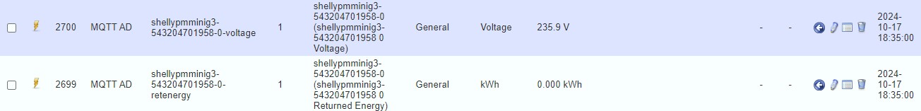

After all, I see it on devices list. But I don't see it on any tab and on mqtt AD configuration.
What did I do wrong ?

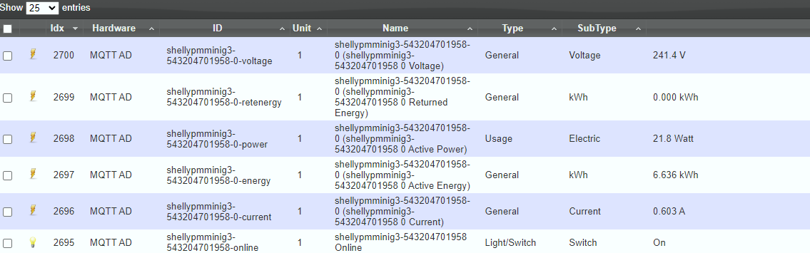

To get it on a Tab you have to enable it from the device list (click on the green arrow). Then it should show up in the correct tab.
If it is already enabled (blue arrow) you probably have another issue that you have assigned devices to a Domoticz admin user. You should not do that. Check menu setup -users.
fantom
Posts: 269
Joined: Thursday 26 March 2015 10:40
Location: Poland
Re: ShellyTeacher for Domoticz
Post by fantom »
I know.
But I don't see this device. On MQTT AD configuration also nothing.
Posts: 7018
Domoticz version: 2026.3
You should see those devices on the Utility Tab. If not check the assigned devices to the current logged in user in menu Setup - Users. If an admin then this assigned devices list should be empty. See also Wiki https://www.domoticz.com/wiki/User_Mana ... et_Devices
fantom
Posts: 269
Location: Poland
Post by fantom »
waltervl wrote: Thursday 17 October 2024 23:56 If an admin then this assigned devices list should be empty.
Thanks. This is solution.
Now I see devices.

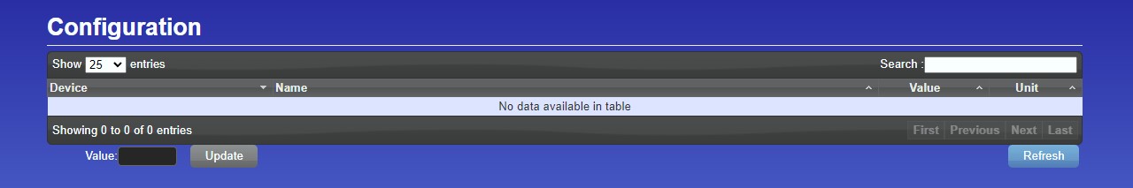

But still on configuration page for MQTT AD list is empty.
Posts: 7018
That is normal. As written in the MQTT AD gateway page this is only for number devices that can set characteristics of a device (eg motion sensor sensibility). If your MQTT AD devices don't have this functionality that configuration device list is empty.
