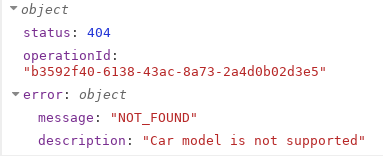

It’s an ev plug-in. So it only supports electric vehicles… Will not work on your car modelpiefje wrote: Wednesday 08 May 2024 14:17 2024-05-08 14:16:07.352 xc60: INFO: retreived a XC60, **********, model year 2021
2024-05-08 14:16:07.352 xc60: ERROR: Selected vin is not an EV, not supported by this plugin
2024-05-08 14:16:07.353 xc60: INFO: Updating Devices
2024-05-08 14:16:07.668 xc60: ERROR: VolvoAPI failed calling https://api.volvocars.com/energy/v1/veh ... rge-status, HTTP Statuscode 404
2024-05-08 14:16:07.672 xc60: ERROR: Reponse: {'status': 404, 'operationId': '0e6f0f29-f141-4796-8a7e-534114c9aef9', 'error': {'message': 'NOT_FOUND', 'description': 'Car model is not supported'}}
2024-05-08 14:16:07.672 xc60: ERROR: Updating Recharge Status failed

I own a Volvo XC40 PHEV 2023 and it used to work until 2024-02-14,15:00 h.
Suddenly they changed something at the Volvo server and since then all Energy API endpoints return:
This is the same for all Energy API endpoints.
Hope they will reverse that change someday or maybe a firmware update of my Volvo will change it.
You wrote:
Unfortunately I have to confirm, that it will NOT work.BTW: based on input of another user i just made a change which should allow PHEV (so also XC60) in the plugin. I have no idea if it works, cause i cannot test myself.

on github the other user reported it does work for a XC60 PHEV (https://github.com/akamming/Domoticz_Vo ... 108473784_)FireWizard wrote: Monday 13 May 2024 19:49 Unfortunately I have to confirm, that it will NOT work.
what is the output for your car for the verhicle api ? (https://api.volvocars.com/connected-veh ... hicles/VIN)
EDIT:
I found the cause why it does not work for XC40 PHEV: On this link you can find the supported models for the energy api:
https://developer.volvocars.com/apis/en ... ailability
This states:
List of supported cars:
XC40 and C40 BEV.
XC60 PHEV, S90 PHEV, V90 PHEV from model year 2022.
XC90 PHEV, S60 PHEV, V60 PHEV from model year 2023.

I'm trying to connect my Volvo EX30 to Domoticz with this plugin, just see if it works. But it seems that it is not possible to register an app trought the Volvo website, I'm getting a 'no healthy upstream' error message when I'm logging into Github, i also tried my Volvo account, but i get the same error. What do I do wrong?
akamming
- Posts: 427
- Joined: Friday 17 August 2018 14:03
Re: Python Plugin: Volvo EV
The ex30 has no api support (yet) by Volvo.rensbr wrote: Thursday 12 September 2024 8:18 I'm trying to connect my Volvo EX30 to Domoticz with this plugin, just see if it works. But it seems that it is not possible to register an app trought the Volvo website, I'm getting a 'no healthy upstream' error message when I'm logging into Github, i also tried my Volvo account, but i get the same error. What do I do wrong?
rensbr
- Posts: 64
- Joined: Friday 27 July 2018 19:01
This Home Assistant plugin works since a few days. Is the logic behind that plugin different than the Domoticz plugin?akamming wrote: Thursday 12 September 2024 8:43The ex30 has no api support (yet) by Volvo.rensbr wrote: Thursday 12 September 2024 8:18 I'm trying to connect my Volvo EX30 to Domoticz with this plugin, just see if it works. But it seems that it is not possible to register an app trought the Volvo website, I'm getting a 'no healthy upstream' error message when I'm logging into Github, i also tried my Volvo account, but i get the same error. What do I do wrong?
akamming
- Posts: 427
I don’t know the code of that solution, but I would assume it uses the same API’s
I just checked the docs )https://developer.volvocars.com/apis/en ... ailability ) and indeed Volvo added the ex30 to the list of supported cars
So in theory it should work now indeed…
I don’t know why you get the error message on the Volvo site: but I would suggest creating an entirely new account on the Volvo developer site…
