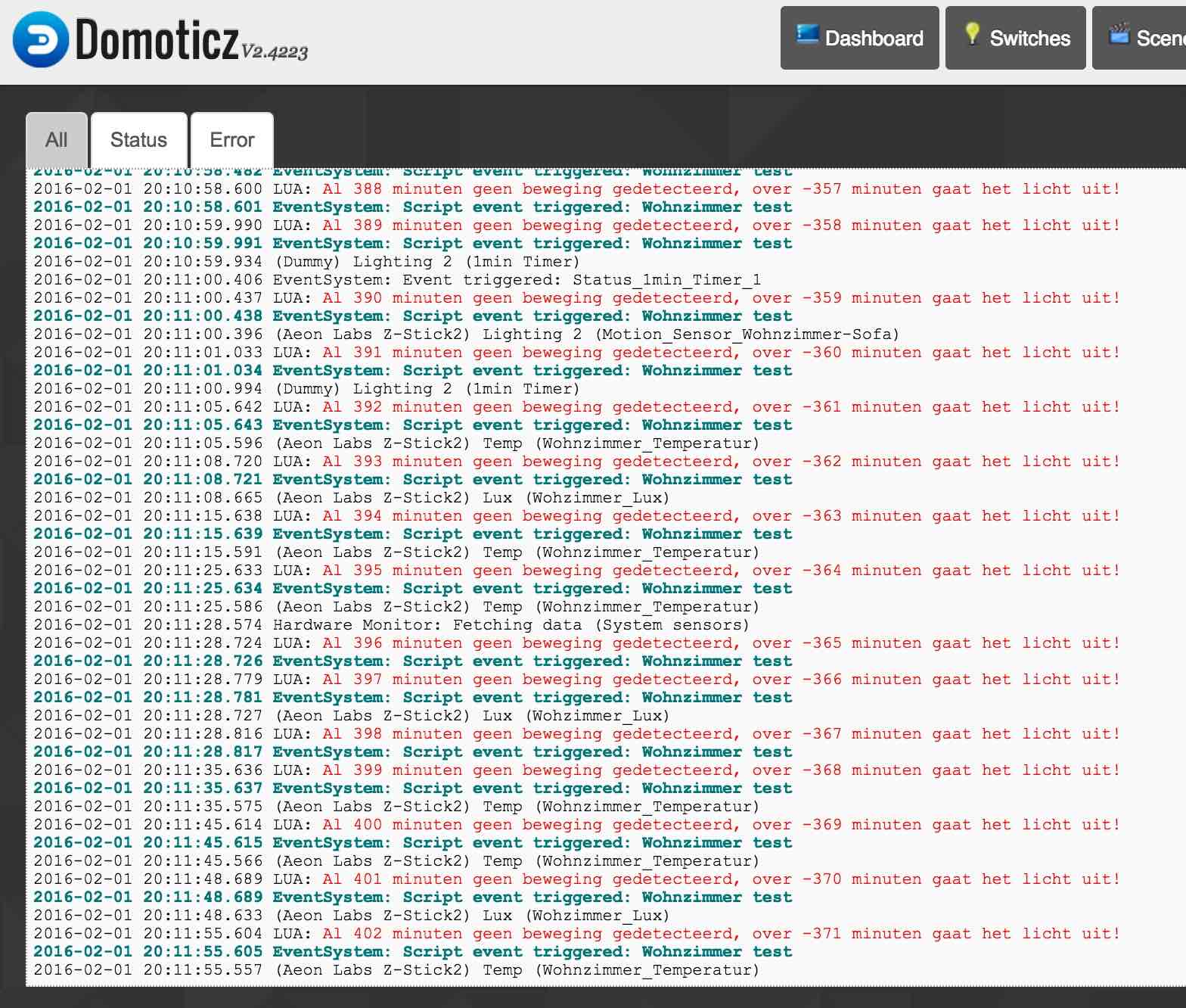

I try to use your script "script_time_nomotion.lua"
-- script_time_nomotion.lua
-- This script flips a switch when no motion has been detected for more than 30 minutes
--Change the values below to reflect to your own setup
local motion_switch 		= 'Motion_Sensor_Wohnzimmer-Küche'
local nomotion_uservar 		= 'nomotionCounter'
local status_switch 		= 'Wohnzimmer_anwesenheit'
local nomotion_timeout		= 30	--Amount of minutes that no motion should be detected to assume nobody is home anymore
no_motion_minutes = tonumber(uservariables[nomotion_uservar])

It counts....but instead of minutes it counts every "system second".
Any idear how i can change it to run only once any minute??
Here is a screenshot
ThinkPad
Posts: 890
Re: Script examples (Lua)
Post by ThinkPad »
You probably have it called script_device.... instead of script_time

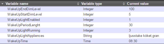

I have create a script that utilizes a few user variables.
WakeUpLightEnabled* -- a number value if the wake up light is enabled or not 1 = enabled 0 = disabled, this should be a integer value
WakeUpTime* -- the time you want to wake up (when the lights reach maximum level), this should be a time value
WakeUpPeriodLenght* -- for how many minutes the light should be running from start to end, this should be a integer value
WakeUpLightRunning* -- just a variable keeping track of for how many minutes the wakeup light has been running, this should be a integer value
WakeUpLightAppliences* -- a comma separated list of the dimmers you want to turn on eg. dimmer1,dimmer2 , this should be a string value
WakeUpStartDimLevel -- start level in % for the dimming (this is not needed, default value is set to 5), this should be a integer value
WakeUpEndDimLevel -- end level in % for the dimming (this is not needed, default value is set to 100), this should be a integer value

    	iWakeUpLightRunning = 0
    	bRunLastTime = true
    --	print("resetting to 0")
    commandArray['Variable:WakeUpLightRunning']=""..iWakeUpLightRunning
    if iWakeUpLightRunning > 0 or bRunLastTime then
        for k,v in pairs(tAppliences) do
            --print("for " .. v .. " Set Level " .. iDimValue.." %")
            iCurrentDimLevel = tonumber(string.match(otherdevices[v], "Set Level: (%d+) %%"))
            print ("Dim level for " .. v .. " = " .. otherdevices[v] .. " is " .. (iCurrentDimLevel or "") .. " target level " .. iDimValue)
            if (iCurrentDimLevel and iCurrentDimLevel == 100 ) or otherdevices[v] == "On" then
                -- the dimmer is already on or 100%. just leave it alone
            elseif ((iCurrentDimLevel and iCurrentDimLevel == 0) or otherdevices[v] == "Off") and (iWakeUpLightRunning > 1 or (bRunLastTime and iWakeUpPeriodLenght > 1)) then
                -- the dimmer has been turned off after the wakeup light started don't turn on again.
            elseif iCurrentDimLevel and iCurrentDimLevel < iDimValue and iWakeUpEndDimLevel >= iDimValue then
                -- increase the dim-level for the wakeup light dimmers
                print ("Dim level for " .. v .. " = " .. otherdevices[v] .. " is " .. (iCurrentDimLevel or "") .. " setting level to " .. iDimValue)
                commandArray[v] = "Set Level " .. iDimValue .. " %"
            elseif iWakeUpEndDimLevel <= iDimValue then
                -- the dimmer has reached the max-value this should be the last run
                print ("Reached the iWakeUpEndDimLevel of " .. iWakeUpEndDimLevel .. " for " .. v)
                commandArray[v] = "Set Level " .. iWakeUpEndDimLevel .. " %"
            elseif otherdevices[v] == "Off" then
                -- first run set the inital value
                commandArray[v] = "Set Level " .. iDimValue.." %"
function checkIfAllUserVariablesExists()
    if uservariables['WakeUpLightEnabled'] == nil then
        uservariables['WakeUpLightEnabled'] = 0
        commandArray["Variable:WakeUpLightEnabled"] = uservariables['WakeUpLightEnabled']
    if uservariables['WakeUpLightAppliences'] == nil then
        uservariables['WakeUpLightAppliences'] = ""
        commandArray["Variable:WakeUpLightAppliences"] = uservariables['WakeUpLightAppliences']
    if uservariables['WakeUpLightRunning'] == nil then
        uservariables['WakeUpLightRunning'] = 0
        commandArray["Variable:WakeUpLightRunning"] = uservariables['WakeUpLightRunning']
    if uservariables['WakeUpTime'] == nil then
        uservariables['WakeUpTime'] = "07:00"
        commandArray["Variable:WakeUpTime"] = uservariables['WakeUpTime']
    if uservariables['WakeUpPeriodLenght'] == nil then
        uservariables['WakeUpPeriodLenght'] = "15"
        commandArray["Variable:WakeUpPeriodLenght"] = uservariables['WakeUpPeriodLenght']
    if uservariables['WakeUpStartDimLevel'] == nil then
        uservariables['WakeUpStartDimLevel'] = "5"
        commandArray["Variable:WakeUpStartDimLevel"] = uservariables['WakeUpStartDimLevel']
    if uservariables['WakeUpEndDimLevel'] == nil then
        uservariables['WakeUpEndDimLevel'] = "100"
        commandArray["Variable:WakeUpEndDimLevel"] = uservariables['WakeUpEndDimLevel']

hope you enoy it.
