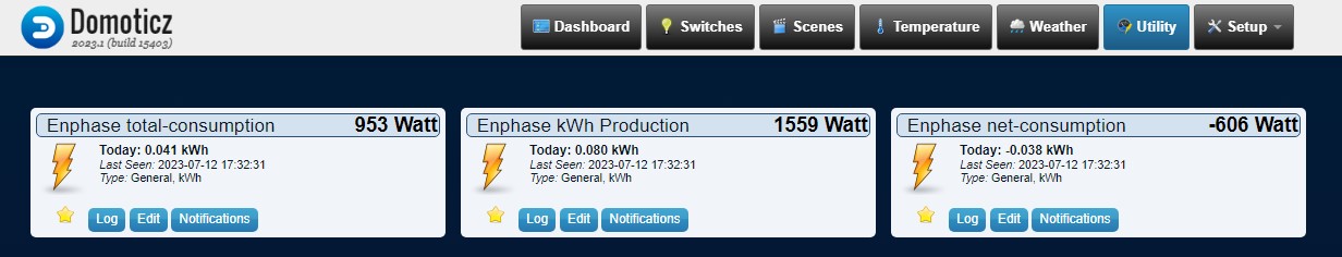

So I have installed, the latest beta on my NAS, and this time, the Enphase plugin works not like the Windows version.
I will let running to see how it goes, but something is very strange, when energy is exported out the grid like this (can't post image link, so I have attached it)
The counter decrease, in the photo, it gives (why I can't write values ???, on Enphase net-consumption, the counter increase the negative value), it shouldn't do that, if value are negative, the energy is give outside, in France, I give it for free, so this counter act like my current power consumed (from the night for ex) is decreasing, this is wrong
This counter should have the same value as my Linky counter, I eventually can understand that if I'm getting battery but even here I'm not sure.
Thanks.
@gizmocuz, I can't even quote your post, I have a warning about : "You can’t post image, email or url links that are external to this domain. Please remove EnphaseAPI."
Thanks.

So it seems to work better on latest version, but, it could be nice to have an option on "Enphase net-consumpsion" to do not decrease the counter when it's negative (when doing export out the house).
On my side, this counter should have the same value as the Teleinfo Linky counter, when power is going outside, I don't keep it and have no fee on it.
Thanks.
Thanks.

Don't worry, so in fact, the counter, the one that show (-0.038), It should be not decrease or increase when power is negative (like -300W for example), if values are negative or 0, then act like it 0, the counter should stay and don't decrease.gizmocuz wrote: Friday 14 July 2023 13:20 Hi, sorry I don't have a metered Envoy. You mean that all negative values should be made positive?
It could be nice to have an option for this, because, I pretty sure for other people for ex that have battery or sell power when going outside the house, want to have the counter decrease, to know the real net power.
Sorry about my language or explanation, I just that I'm enough clear

I will test, but to be sure that we understand it right together, the negative value from the wattage is ok.gizmocuz wrote: Friday 14 July 2023 13:58 @Sebastii, could you check beta 15420.
In this version the net-consomption should be positive. It's strange that Enphase reports this as negative.
Sure it is a negative feeling, but it is what it is... just consumption.
In the above image, we can see that we have : "-1566 Watt" as reported, this is correct behavior, this means that there is export out the house and I use with a script to detect this negative value to know if I can start an electrical outlet to control a for ex air conditioner
So this value need to be reported as negative when is export
But the counter where is indicated : "0.590 kWh" should not decrease when a negative watt is running (exporting power outside the house).
In fact, this counter (0.590 kWh) should have around the same counter number of LinkyStdMode : (7.715 kWh), right now, the counter mismatch because when the "Watt" is negative like right now, this counter decrease !
As you can see while I'm writing the answer, the counter decrease again ! It's now "0.412 kWh" (in fact, it should not decrease when the Watt are negative)
So your latest change goes like I'm explaining above ?

The only way to know is to see the negative value, this means, we export to Network and in final the counter shouldn't move when we export to network.
Exporting to grid (so negative value)
When I consume more than the production permit, it indicates : "Importing from Grid"
If we keep value as positive, then we should indicate if it's an export or import, but to use on script, it will be worst to code I think !

So I can confirm no negative value but that not correct finally because positive value can be exporting or importing, so we can't know it anymore !
I hope you are following me

So maybe we have to do only this ?
Only update counter when it's positive and let negative value because it's to indicate that we are exporting ! (because here we talk about net consumption and not production)
What do you think ?
Still, maybe this need on option because if in other country, all export is automatically sell as 1 kWh export = 1 kWh import then here it can be logic to have the counter decrease when we export !
On my side, I didn't sell it
Thanks.

Okey, I leave the counters as it is reported. Beta 15436 is not touching it anymore
