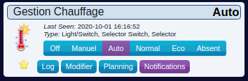

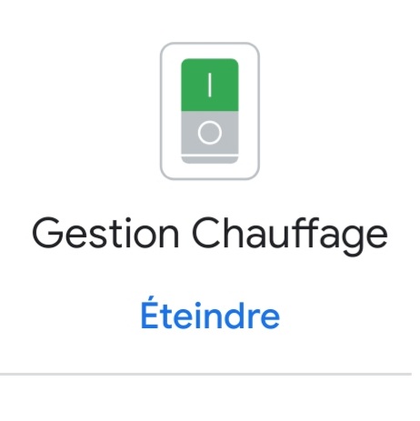

transalpes
Posts: 10
Joined: Thursday 17 October 2019 12:57
Re: Domoticz-Google-Assistant (dzga)
Post by transalpes »
Hello DewGew,
I continue to advance in my construction, and I encounter the following difficulty:
I have a device selector in domoticz:
Capture d-ecran du 2020-10-02 23-33-30.png (20.5 KiB) Viewed 3302 times
it appears well in "domoticz google assistant" as a selector:
Capture d-ecran du 2020-10-02 23-34-46.png (5.27 KiB) Viewed 3302 times
But in google Home it is recognized as a simple switch "on and off":
I don't understand my mistake, can you help me please,
thank you for your return

DewGew
Posts: 581
Domoticz version: V4.10618
Location: Sweden
Post by DewGew »
transalpes wrote: Wednesday 07 October 2020 9:30 Hello DewGew,
Friendship
There is no touch control for selector. After all is voice assistant ;) it should work with voice e.g:
User:Hey Google, Activate Normal on Gestion Chauffage.
Google Assistant: Activates Normal on Gestion Chauffage.
