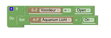

Hi guys, I would like to start using Blockly but nothing I try seems to work...
Just made a simple blockly set up to test if it works, but even this doesn't:
Schermafbeelding 2014-10-03 om 08.38.41.png (16.06 KiB) Viewed 14924 times
Is there anything you should do besides click save in the Blockly editor? (I clicked active too)
Do I need to put the freshly created Blockly in devices or switches or something like that?

I don't know for sure if this works without the "else" because this is a "if else" start block.
Try a "if do" block works first.
Maybe the open should be "on" ? (seen that before, sensor sends an "on" command and due to setting the switch to doorsensor it is just shown as open)
dit you enable "events" in the application settings ?
*/ Just A Byte /*
joske522
Posts: 18
Joined: Friday 19 September 2014 20:46
Re: Blockly examples
Post by joske522 »
LanWolf wrote:I don't know for sure if this works without the "else" because this is a "if else" start block.
Hi LanWolf,
thanks! The If Do block works like a charm! Thanks for the tip! :D

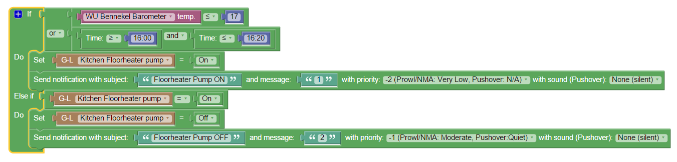

Hi all, first a big thumbs up for domoticz, i have been playing around with it for some time now and must say i love it! Great work!
However i am currently struggling with understanding the logic of the "IF DO ELSE IF DO..." control blocks.
Note this is different from the IF-DO block which works as expected: IF (condition) DO (action)...simple. I can best illustrate my problem with the following:
I have a floorheater pump that is controlled by a kika like switch, works.
I wish to have the floorheater pump turned off when the outside temperature rises above a certain level. I wish it to be on below a certain level OR at least run for 20 minutes daily.
What i came up with is attached. I intentionally left out the evaluation to only turn it on if its not turned on already because that would trigger trigger the second evaluation immediately after it had been turned on.
The problem: the second evaluation (ELSE IF "PUMP=ON") counts even when its below the 17 degrees, or time is within that interval specified in the first evaluation. I would expect the second condition only to be evaluated IF the first condition is not met/true. What happens now (temperature outside well below 17 degrees) if it is switched on it immediately is switched off. It seems like it will evaluate the second condition even if the first one is true.
What have i overlooked here? The behavior i am seeing now is like having 2 separate IF DO blocks, not IF DO ELSE IF.
Thanks for any help/thoughts.
A lua script wont work here: i am both triggering based on both time of the day and device status.
I am using the current stable.
PS: I think i read somewhere IF DO ELSE (no second IF) were not possible by design. Can we work around that by using these IF DO ELSE IF blocks with a second condition that is always true? I have to admit i have tried that but have not found anything that works (like with a IF 1==1 like condition), maybe that is related to what i am not seeing correctly here??

I am not quite sure why you can't use Lua - you can't have a script which is triggered on both time and a device, but two scripts which talk to each other via a dummy switch allows for both.
Personally I don't think Blockly is easy once you get to this level of complexity.
DaaNMaGeDDoN wrote:I wish to have the floorheater pump turned off when the outside temperature rises above a certain level. I wish it to be on below a certain level
script_device_pumptemp.lua - script triggered by when temperature changes - if high switch off (if dummy override switch is not on), if low switch on - what you can also do is measure the length of the time the pump is on for and keep a running total for one day in a uservariable.
DaaNMaGeDDoN wrote:OR at least run for 20 minutes daily.
script_time_pumptemp.lua - script switches pump on at 16:00 if cumulative pump on time for the day is less than 20 minutes then switches pump on for enough time to make up 20 minutes, calculate stop time and stores in uservariable, switches on a dummy override switch, always resetting cumulative pump on time to zero. Script then switches off at time in uservariable, turns off dummy switch.

Hi see my picture.
There is the option if do and the else if if you press the + sign
In domotics its Setup > more options > events.
Guess with my blocky i did some thing wrong as its dark and the light is still off.. :(
perhaps it would be nice if there would be a test option in the scripts..

I now have:
Will this work?
