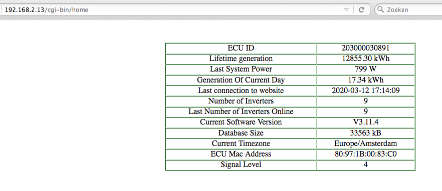

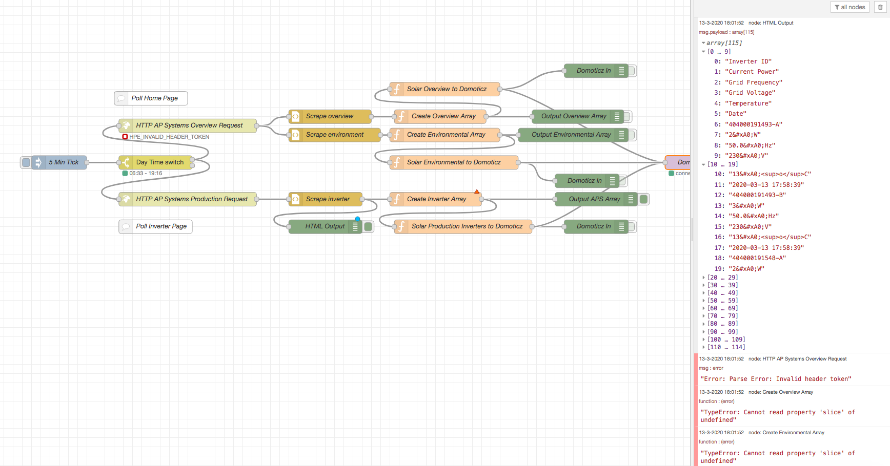

Great tutorial, have worked my way through it but keep running into some problems. I think it has something to do with the fact that the URL' s look different. (eg: i do get some output but can't get it to look the same as what the posts show)
my 'home' url looks like: http://192.168.2.13/cgi-bin/home
it creates an error and no data output

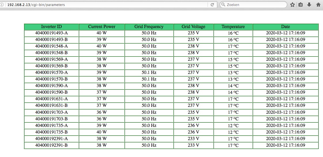

my 'realtimedata' url looks like: http://192.168.2.13/cgi-bin/parameters
it does give some output but it does not compare with the examples

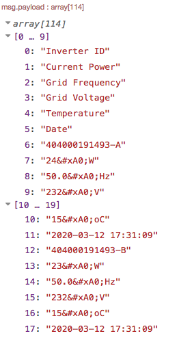

Schermafbeelding 2020-03-12 om 17.32.03.png (46.9 KiB) Viewed 3067 times

As you might have noticed, there exist a difference between the webpage in your version and @Benneton version. It means, that we have to modify the first "Function" node. As @Benneton has 6 inverters and 12 solar panels and you have 9 inverters with 18 solar panels, we have to modify the second "Function" node as well.
1. The overview page.
There is a difference between to two versions and also the URL is different.
Your URL: http://<IP Address>/cgi-bin/home, @Benneton URL: http://<IP Address>/index.php/home
I can imagine. Did you change the URL to the overview page?
But as there exist a significant difference between the versions, I suggest we handle that later.

Your real time data is available at http://<IP Address>/cgi-bin/parameters. I see that you have changed the URL, because you receive real time data.
In version 4.1 the URL is: http://<IP Address>/index.php/realtimedata
In your second screenshot I see that the received data is more or less the same as, what @Benneton receives.
If we look at the table in the second screenshot, you will see it consists of 19 rows and 6 columns
The rows includes the header and 18 solar panel data.
You see also that it is nicely saved in an array with contains 19 x 6 = 114 elements (See your third screenshot)
You see also the data. This means that the "Selector" in the html node, marked "Scrape inverter" is OK.
Before we modify the first "Function node", you have to decide, which sensors should be sent to Domoticz.
Each Row contains the following in their respective columns:
- Inverter ID: 2 Solar panels, marked A and B. They will be used as the key.
- Current Power for each panel; that is obvious and has to be sent to Domoticz
- Grid Frequency; it is indicated for each panel, but in version 4.1 it is only indicated per inverter.
It is identical for the A and B panel. So indication per inverter is probably sufficient.
- Grid Voltage; it is indicated per panel, but is it needed per panel? We kept it in v4.1
- Temperature, See the comment for Grid frequency.
- Date is not used as this is created in Domoticz.
Of course it is possible to modify the first "Function" node for all possibilities, but I suggest that you indicate, which sensor you want to have presented in Domoticz. Of course the Current Power per solar panel, but do you want the Grid frequency, Grid Voltage and Temperature per panel or per inverter?

@Firewizard
I made a clean flow with the data for the complete flow.
- changed the url's to match mine
- replaced the script with the given
screenshot of the outcome:
The only output is on the debug: HTML Output
the: Output APS Array comes up empty =====> "SyntaxError: Unexpected token ')'"

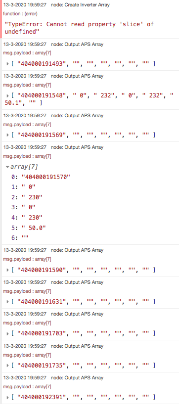

Posted: Friday 13 March 2020 20:04
by Macguyver
Schermafbeelding 2020-03-13 om 20.01.48.png (98.74 KiB) Viewed 3046 times
@Firewizard
Yes this looks more like it.
guess the empty lines are because its dark and they are '0' now?
Re: how to add APSystems ECU-3 solar inverter monitor
Posted: Friday 13 March 2020 22:01
by FireWizard
@Macguyver,
I see at least 9 arrays, each with 7 elements. They corresponds with the ID's (serialno's) in the webpage table.
- Micro-inverter ID (without A or B)
- Current Power A (currently 0 W, because it is dark)
- Grid Voltage A: 230V
- Current Power B (currently 0 W, because it is dark)
- Grid Voltage B (identical with Grid Voltage A): 230V
- Frequency (50Hz)
- Temperature Empty. A little strange, that if it is dark, no temperature is given.
Except 2 arrays, all other arrays are empty.
You can check that, if you see that the corresponding cells in the webpage are also empty. I expect that.
I expect that tomorrow, and hopefully we have some sun, all the arrays are filled.
The error message (Cannot read property 'slice' of undefined) is probably also caused by missing values.
In v4.1 I did not noticed that.
I believe that the first "Function" node is correct now and you can continue with the second one.

[Edit] A check between v4.1. and v3.11.4 turned out that a difference between the two tables exists, so the error message (Cannot read property 'slice' of undefined) is probably also caused by this difference.
In the first function node replace:
newMsg = {payload: ([InverterIDA.substr(0,12),CurrentPowerA.slice(0,-2),GridVoltageA.slice(0,-2),CurrentPowerB.slice(0,-2),GridVoltageB.slice(0,-2),GridFreqA.slice(0,-3),TempA.slice(0,-8)])}
with
newMsg = {payload: ([InverterIDA.substr(0,12),CurrentPowerA.slice(0,-7),GridVoltageA.slice(0,-7),CurrentPowerB.slice(0,-7),GridVoltageB.slice(0,-7),GridFreqA.slice(0,-8),TempA.slice(0,-8)])}
Let me know what the result is, when the sun shines.

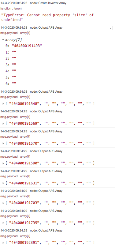

Posted: Saturday 14 March 2020 9:38
by Macguyver
Goodmorning @Firewizard
Yes the sun is up and i have data coming in!
*that being the case with your original script, the edit you wrote makes all data go blank
*no temperature data.
WITH EDITED CODE
Schermafbeelding 2020-03-14 om 09.34.42.png (95.17 KiB) Viewed 3027 times
WITH ORIGINAL CODE
Schermafbeelding 2020-03-14 om 09.35.28.png (109.22 KiB) Viewed 3027 times

Can you provide a (new) screenshot from
1. The webpage showing the table, with the individual inverters/solar panels
2. The output of the debug node, marked HTML output, which is attached to the html node, marked "Scrape inverter".
3. Output of debug node, called "Output APS Array" connected to the Function node, called "Create Inverter Array".
The size of that post is quite big, you may put it in a ZIP file.

Posted: Saturday 14 March 2020 12:11
by Macguyver
@FireWizard
See attached.
gr,
Macguyver

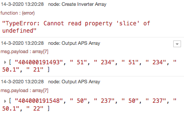

Posted: Saturday 14 March 2020 13:23
by Macguyver
@FireWizard
Think i got it... no clue how it works, but looking at the alternative scriptedline you send i started altering the last digit from your scriptline.
newMsg = {payload: ([InverterIDA.substr(0,12),CurrentPowerA.slice(0,-2),GridVoltageA.slice(0,-2),CurrentPowerB.slice(0,-2),GridVoltageB.slice(0,-2),GridFreqA.slice(0,-3),TempA.slice(0,-3)])}
Changed that digit for TempA.slice(0,-X) to a : -3 and now Temperature is showing.
The error remains though.
Schermafbeelding 2020-03-14 om 13.20.35.png (37.58 KiB) Viewed 3023 times
gr,
Posted: Saturday 14 March 2020 17:03
by FireWizard
@Macguyver
This screenshots helps a lot.
One of your first screenshots, dated "Schermafbeelding 2020-03-12 om 17.32.03.png (46.9 KiB) Viewed 49 times" caused the trouble.
The first one is much better.
I will study it and come back to you.
I will explain:
As an example I will use the temperature.
The variable has got the name TempA (which is equal to TempB) en therefore we will use only one, so TempA.
The output from the HTML node (debug node, "HTML Output") gives for all temperatures the following: " 23 oC"
That is not what I want. I only want the figure " 23" and so I want to get writ off a space (between 3 and o), o and C.
This is totally 3 characters.
Slice does that exactly.
See e.g. https://www.w3schools.com/jsref/jsref_slice_string.asp
In this case TempA.slice (0,-3), chops the last 3 characters of from the right.
So, if TempA is equal to " 23 oC", then TempA.slice(0,-3) will be " 23" and that is what we need
The unit oC is added in Domoticz.
