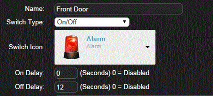

Set an "off delay" for 10 seconds in the switch settings. that' how I use mine

sultanhq wrote:
decrxgarage wrote:I bought also some of the 2262 switches but due to the fact that it only sends on "Off" or only an "On" command. I thought this wouldn't be a problem because I thought this would be solvable with some blocky events. But it does not send only an "Off" signal but the switch is also on "Off" and stays "Off". Therefore you can create a blocky event but this gets into a loop (switch is set to "on" therefore it is set to "off" and that sets it to "on" etc.) or doesn't doe anything at all.
Somebody knows a solution to this?
Can you post a screenshot?
sultanhq
Posts: 6
Joined: Wednesday 23 July 2014 22:21
Re: Low cost window/door sensor
Post by sultanhq »
decrxgarage wrote:

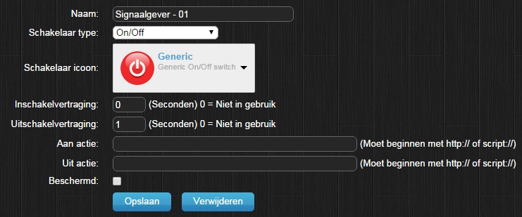

I have it working now but there is some strange thing in the blocky.
I named the PT2262 switch "Signaalgever - 01" and added a switch off delay of 1 second.
Signaalgever - 01
Signaalgever - 01
Signaalgever - 01.jpg (69.58 KiB) Viewed 8659 times

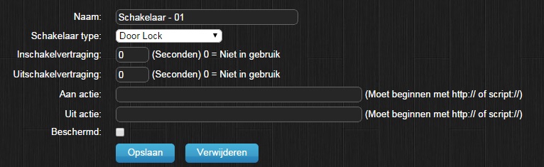

Then I created a virtual sensor called "Schakelaar - 01"
Schakelaar - 01
Schakelaar - 01
Schakelaar - 01.jpg (57.48 KiB) Viewed 8659 times

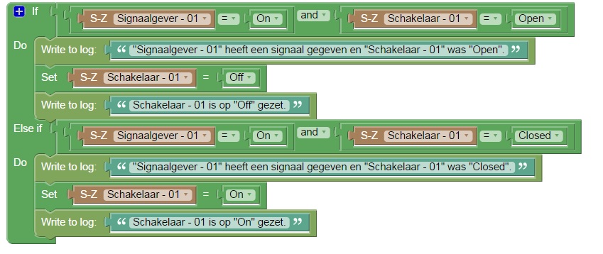

With this 2 I created a event.
Blocky
Blocky
Blocky test.jpg (101.88 KiB) Viewed 8659 times
This works but the thing I think is a bug is the "Schakelaar - 01" must be "On" or "Open" but i have to set them to "On" or "Off". So if i change in the above "Open" to "On" and "Closed" to "Off" it doesn't work anymore.

I think that schakelaar - 01 must be contact instead of door lock as switch type.
roblom
Posts: 408
Joined: Wednesday 26 February 2014 15:28
Location: the Netherlands
Post by roblom »
mbliek wrote:I think that schakelaar - 01 must be contact instead of door lock as switch type.
That's possible but the PT2262 switch is connected to a door so thats why I used the doorswitch. Nevertheless is works but not as I expected because the state is "Open" and it must be set with a "On" command.
mbliek
Posts: 194
Joined: Friday 12 July 2013 14:08
Post by mbliek »
But a door lock is a electric lock on the door.
So On means door locked and open means door unlocked.
The switch type contact is an magnetic contact that detects if the door is open or closed.
