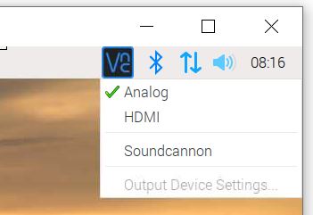

I followed the steps in your guide (see pictures attached). For the record I have only one station selected in your software just to try if it works.
The problem is that when I connect my soundbox by bluetooth to the Pi it tells me to change the output device in the player menu. So you can see on the pictures attached there is much choice in selecting a output device. When I select Bluetooth as a output device I get a failure with the message that the output device is not recognized.

Yes I did, no sound was heard.
The system is telling me to choose a device for audio output. My BT speaker is showing in a list of devices bud I cannot select it.
See attachmend.
