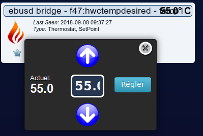

Yes you can, some parameters or the boiler are read/write, for instance:
Sometimes it's difficult to understand what are the parameters for, but I can help, do you have a specific need?

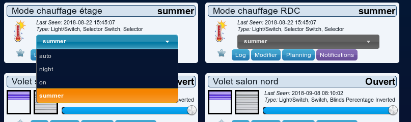

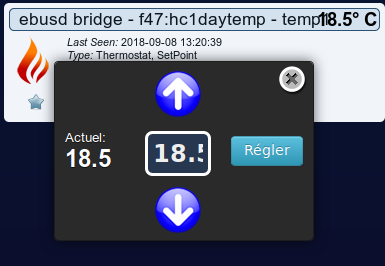

I guess it depends on your specific boiler model. On mine, I can set it with f47:Hc1DayTemp f47:Hc1NightTemp for my first heating circuit but cannot find the temperature registers for the mixing circuit of my second heating zone:

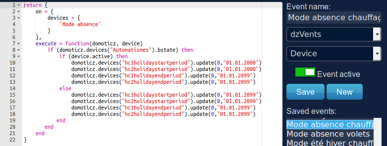

In my dzVents script example, I switch between holidays and normal mode depending on a virtual switch "Mode absence" where I use Domoticz planning feature.
You can also switch between auto/night/on/summer mode for each heating circuit with f47:Hc1OPMode for 1st zone and mc:InternalOperatingMode470 for 2nd zone on my installation. This can be done using dzVents or Blocky scripts or from interface:

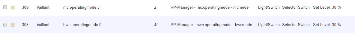

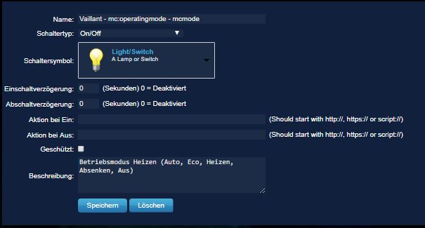

The two entries
mc:OperatingMode hwc:OperatingMode
provided each a selector-switch, with the working buttons for mc: "Auto, Eco, Heizen, Absenken, On" and for the hwc: "Off, On, Auto" (I do not remember the order).
Now I have removed all my tested components and created all needed again. Now the two entries deliver a selctor-switch in the devicelist, but the switches are created as normal-switches (without buttons).
I have tried:
to remove all devices
Remove hardware in the list
Restart Domoticz
all sorts of other entries
What am I doing wrong?
