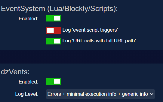

With regards to the log; the above loglines are not specific for this script but are generic for all dzVents scripts based on the settings.
Did you try to change the event / dzVents log settings via [setup][settings][other] bottom of the page (see below)?
log settings.png (22.26 KiB) Viewed 2532 times

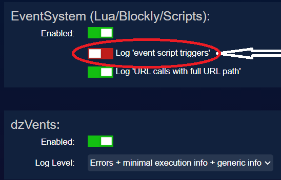

waaren wrote: Tuesday 06 April 2021 17:35 ...
According to the time stamp, the script is triggered every second and that is most likely the result of the setting for the P1 hardware update frequency.
@waaren: question to you: is it possible to avoid the following log line as well?
"Status: EventSystem: Script event triggered: /home/pi/domoticz/dzVents/runtime/dzVents.lua"

Re: LUA – Virtual Solar Battery: simulate the presence of a battery for storing harvested solar energy
jake wrote: Tuesday 06 April 2021 17:46 @waaren: question to you: is it possible to avoid the following log line as well?
Yes.
