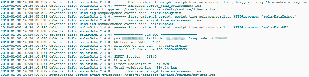

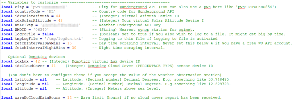

Anyone have any idea what could be the issue here?
The Cloud Cover device is at 100%, whereas there are almost no clouds at the moment.
The Lux device value seems to be very low, not corresponding with the time of day.
The Azimuth and Altitude values seem OK?

The PWS which I use is working fine.
ID numbers are all correct, just double checked.
WMOID taken from the Ogimet website; 06340: Woensdrecht (Netherlands).
LUA Script
LUA Script
2018-01-30 16_27_33-script_time_solarsensor.lua.png (118.84 KiB) Viewed 6142 times
What is causing this issue with the Cloud Cover and Lux devices?

Below a screenshot of the log.
Log
Log
2018-01-30 16_41_04-Log.png (40.14 KiB) Viewed 6136 times

What is the distance of woensdrecht and your weatherstaion pws:xxxx In my situation it is over 16km. It can be 100% cloud cover at the Ogimet and a bright sky at my weatherstation.
Greetings McMelloW

60 KM... You've got a point.

I discovered the same difference in my situation. Ogimet is taken from Lelystad Airport. pws is at Harderwijk, only 600m from my house. The distance in direct line is only 16km. Still there can be large differences in local weather.
Greetings McMelloW
