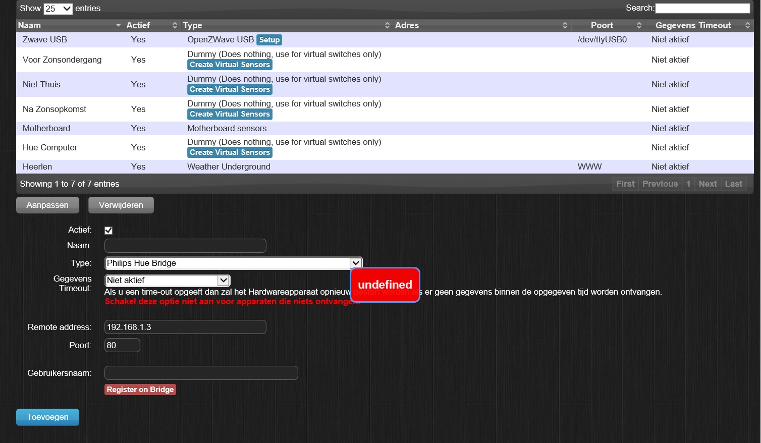

Hi Gizmocus,
It still not works. Even when I let the username empty I get the same error message.
It looks also when I don't press the button om my bridge i get the same error.
The bridge is working. I can control all the light with my Phone.
Here you can see my hardware page. What am I doing wrong?
EDIT: I did see in my own print screen that I didn't type a name for the hardware device. But this is also not the problem.
Hardware Page
Hardware Page

@ brutus:
Otherwise, try to first insert a newdeveloper through the wiki.
http://www.developers.meethue.com/docum ... ng-started
Then in Domoticz only: newdeveloper as the user without the register button..

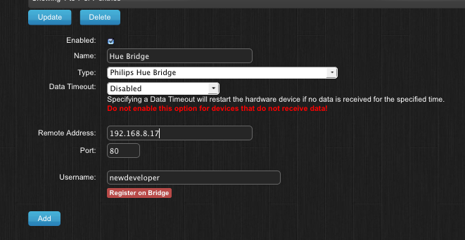

Brutus wrote:Here you can see my hardware page. What am I doing wrong?
This is what my hardware page looks like.
Screen shot 2014-10-26 at 17.22.13.png (86.79 KiB) Viewed 7817 times
As @Derik says without the register button, and you need to click Add before it is available.

@ Derik and simonrg
When I created a new user in the API, I was able to add my lights :)
Thnx for the help.

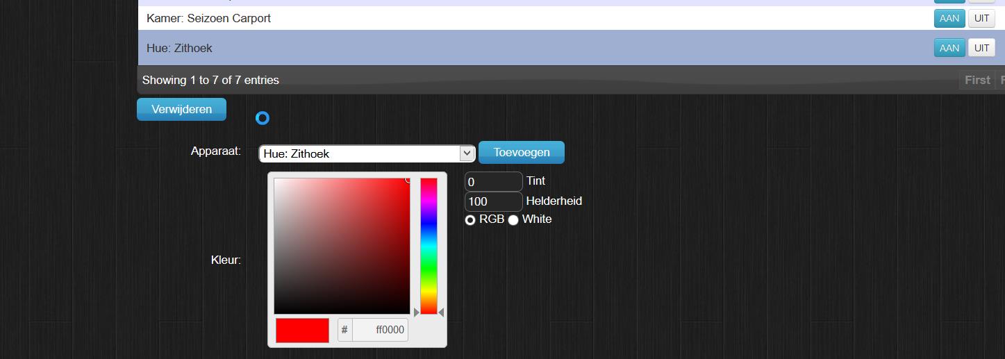

Maybe when you can answer this question :P
With Philips Hue you get one Switch. With this switch you can set the Hue on/off and change the color. The last color is then remembered.
I wan't the Philips Hue lights to light RED when there is someone on the door. After 10 sec the lights need to go back where they ware at. (mostly this is Worm White).
With the Fibaro RGBW Controller for example this is possible because I have switches for each color. Then I can use the White one for nomal use and the Red on for alarming.

Tsja..
In dutch no problem for me...
In englisch...
Create a group or scene with the Hue and a dummyswitch as the "masterswitch."
Create in this scene a color say red... and call this scene or group red
Then it is appeltje eggje...
when x happend.
Activate the group/scene for x second....
Very good for me ??... [ without google translate.. hahahaha ]

I'm trying this now ;)
For the help I give you all my Domoticz ;) Next time you can also type a PM in dutch to me ;)
The only thing is you can only activate or deactived a group or scene. Nothing with time or something like that.

One thing I noticed is when you use the Hue lamps in a scene or group the brightness is Always 100% even when i set it at 50% or 30%.
Greetings Brutus

There was a problem with registration, a new beta is coming #2088, now you can register before adding the device
