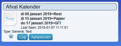

freijn
Posts: 536
Domoticz version: Stable
Re: Sharing : Afval kalendar in text sensor
Post by freijn »
jvdz wrote: Monday 07 January 2019 10:40 Just update the dummy record in the Table to a time 1 minute from Now to force the update to see if it works. ;)
Jos
Jos I did :
["Dummy"] ={hour=10,min=51,daysbefore=0,text="dummy"}}
now, 10:57, nothing happenend...
Was this what you meant by updating?
freijn
Posts: 536
Post by freijn »
2019-01-07 11:03:00.817 Error: EventSystem: in AfvalAlarm: [string "-- AF-PUR module to get the Afval schedule fo..."]:145: bad argument #1 to 'gmatch' (string expected, got nil)
freijn
Posts: 536
Post by freijn »
local MyArea='Weidevenne+en+Hazepolder'
had to put + in between, perhaps a remark in the notes?
jvdz
Posts: 2441
Domoticz version: 4.107
Post by jvdz »
freijn wrote: Monday 07 January 2019 11:20 local MyArea='Weidevenne+en+Hazepolder'
Good to see you fixed it and yes you do need to get the MyArea from the URL after you selected the "WIjk". Will make a note in the script in the comment behind the field.
