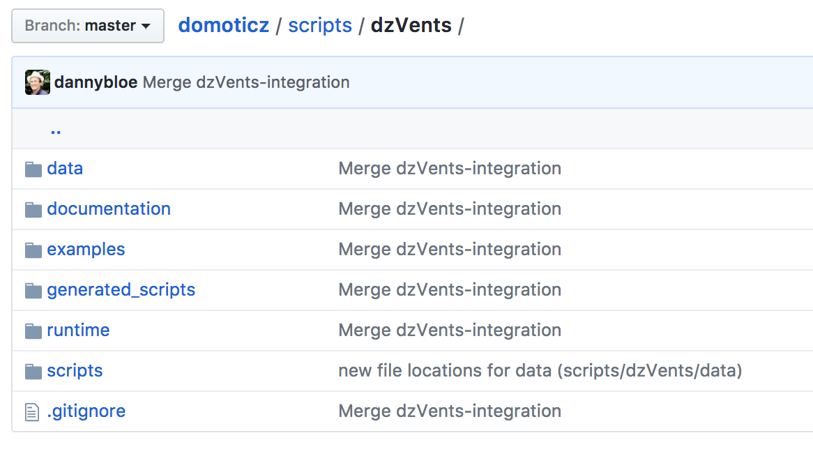

dannybloe wrote:Don't worry about that. I see you have debug mode enabled. That does slow things down though.
Yes, it is enabled on my test VM, but disabled on my Pi (not possible to used anyway if I enable dzVents...
-> I do not use any version of dzVents: no "dzVents" folder in my "lua" folder...
-> "dzVents_settings_example.lua" is back inside "/scripts/dzVents" when I force a beta update via ./updatebeta, and I have errors if I have dzVents enabled on the web interface and no "dzVents_settings.lua" file in "/scripts/dzVents".

That's totally weird as in the repo there is no such file in that folder.
Screen Shot 2017-07-02 at 16.37.09.png (123.3 KiB) Viewed 3932 times

dannybloe wrote:That's totally weird as in the repo there is no such file in that folder.
Just tested it again : I moved the incriminated file into a "old" folder, and then redo the ./updatebeta.
this time it did not came back, and my dzVents script is still working... (on my test VM). I do not understand what this file was doing there at the first place, because I will never have thought about creating it ! -> now I will try to remove it on my RPI and see what happen *crossing fingers*
