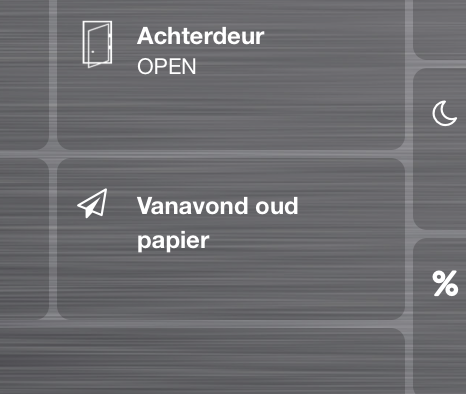

Coloured trashcan working over here. Subtle and very nice! Thanks Rob
Question:
My city works with several different companies who collect paper. For this, they have a PDF file with the dates. I'd like to have this in the dashboard.
If I put the dates (for my location) in a .txt file, or whatever file, could there be something added to Dashticz so the file (use CONFIG.js for the location) can be read and the data can be displayed in an extra block? Maybe a komma-seperated file or something? Like:
Edit:
for now (I hope Rob can make something so I / we can use a .txt file or something to use in the Dashboard) I altered the bin_selecter script to only show me the dates for picking up the paper. I changed it so you now if it's the week the paper is picked up, if it will be picked up tomorrow and if it will be picked up tonight (in my situation it will be picked up every uneven week on Thursday evening).
I haven't tested it yet, but for today it all seems to work:
Question:
11-05-2017,25-05,2017, etc
week = tonumber (os.date( "%V"))
dag = tostring(os.date("%a"));
status = tonumber(otherdevices_svalues['Paper'])
print('script paper_script executed')
-- Every Thursday evening in the uneven weeks paper get's picked up here.
-- IDX 3573 is my dummy text utility (see below) called 'Paper' (see above)
-- If in your city the paper is picked up in the even weeks, change the ~= to ==
if (dag=='Sat' or dag=='Sun' ) then
weekend = true; weekdag = false
if (dag=='Mon' or dag=='Tue' or dag=='Wed' or dag=='Thu' or dag=='Fri') then
weekend = false ; weekdag = true
--Bepalen morgen papier
if(week % 2 ~= 0 and dag=='Wed') then
morgenpapier = true; papier = true; vanavondpapier = false
-- ('Morgen papier')
--Bepalen vanavond papier
if(week % 2 ~= 0 and dag=='Thu') then
morgenpapier = false; papier = true; vanavondpapier = true
-- ('Vanavond papier')
--Bepalen deze week papier
if(week % 2 ~= 0 and dag~='Wed' and dag~='Thu') then
morgenpapier = false; papier = true; vanavondpapier = false
-- ('Deze week papier')
if (papier and weekdag) or (papier and weekend) then
commandArray ['UpdateDevice']= '3573|1|Deze week oud papier'
if (morgenpapier and weekdag and papier) then
commandArray ['UpdateDevice']= '3573|1|Morgen oud papier'
if (vanavondpapier and weekdag and papier) then
commandArray ['UpdateDevice']= '3573|1|Vanavond oud papier'
if (not(morgenpapier) and not(papier) and not(vanavondpapier)) then
commandArray ['UpdateDevice']= '3573|1|Deze week geen oud papier'
return commandArray
