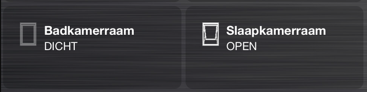

Fixed....
using Rob's code, but for the sensors you have to change the 'Off" to 'Closed" (of course.....) like this:
function getBlock_3534(device,idx){ //change 124 to the idx of your device!
   $('.block_'+idx).attr('onclick','switchDevice(this)');
   var html='';
   html+='<div class="col-xs-4 col-icon">';
      if(device['Status']=='Closed') html+=iconORimage(idx,'','window_closed.png','off icon');
      else html+=iconORimage(idx,'','window_open.png','on icon');
   html+='</div>';
   html+='<div class="col-xs-8 col-data">';
   html+='<strong class="title">'+device['Name']+'</strong><br />';
   if(device['Status']=='Closed') html+='<span class="state">DICHT</span>';
   else html+='<span class="state">OPEN</span>';
   if(_SHOW_LASTUPDATE) html+='<br /><span class="lastupdate">'+moment(device['LastUpdate']).format(_LASTUPDATE_FORMAT)+'</span>';
   html+='</div>';
   return html;

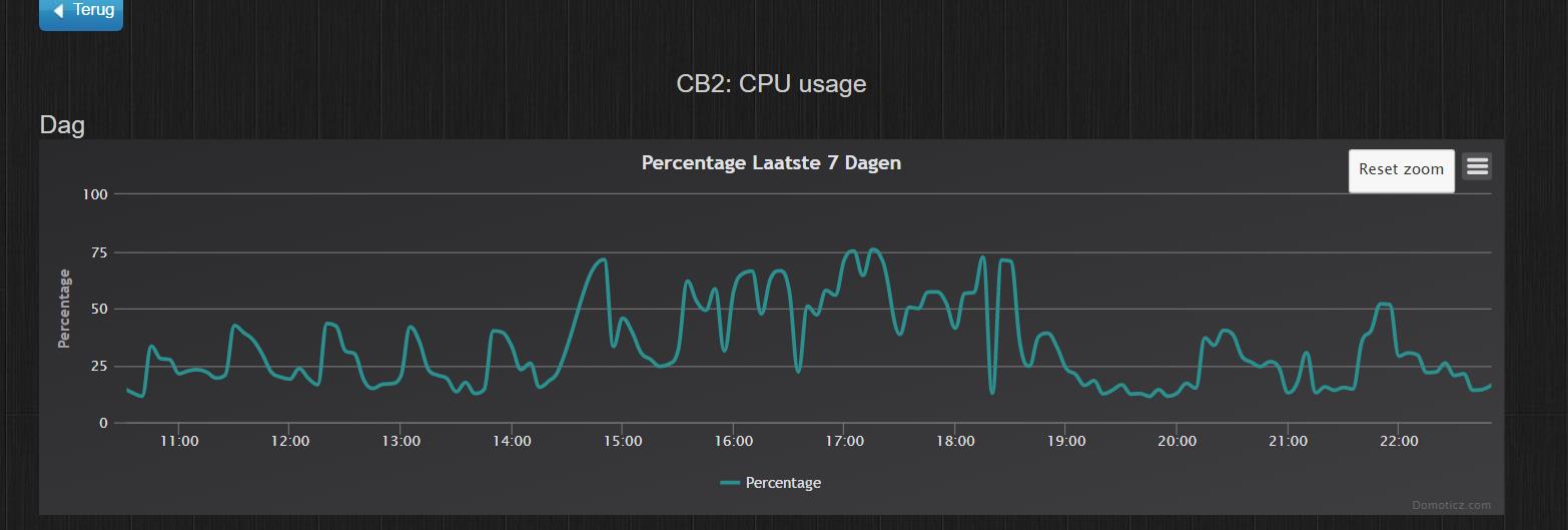

I checked for the bug which causes issues with displaying the graphs for _1 en _2 devices.
I changed two function in blocks.js for this:

I din't find anything yet for the problem the graph isn't readable with a 7 day log. Domoticz always return 7 days (or the number of days set in the setting). I think the result have to be split in pages for each day to make it readable.
robgeerts
Posts: 1273
Domoticz version: 3.7067
Re: Dashticz - Bug report
Post by robgeerts »
Thanks I fixed this in latest beta!
About the 7 day problem, will look into this..

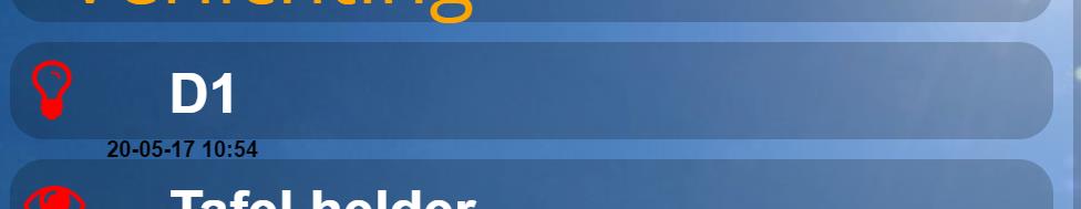

Did set the ping:
blocks[9] = {} // D1 Kamer
blocks[9]['width'] = 12; //1 to 12, remove this line if you want to use the default (4)
blocks[9]['title'] = 'D1' //if you want change the name of switch different then domoticz
blocks[9]['icon'] = 'fa-lightbulb-o'; //if you want an other icon instead of the default, choose from: http://fontawesome.io/cheatsheet/
blocks[9]['switch'] = true; //if you want to switch the title and data
blocks[9]['hide_data'] = true; //if you want to hide the data of this block
blocks[9]['show_lastupdate'] = true; //if you want to show the last update specific for this block
blocks[9]['playsound'] = 'sounds/ping.mp3'; //play a sound when a device changes
blocks[9]['protected'] = false; //protect switching manually in Dashticz
Nice the button change a ping great new feature...
Only now i get 2 pings...
1 when the button change.
And after 2-3 second a ping again...
Because the data change...
Please a option for 1 ping :-)
robgeerts
Posts: 1273
Post by robgeerts »
But the date should only change when the state of the switch is changed??
Derik
Posts: 1605
Post by Derik »
Mmmm
I did found the problem....
I swtched a scene..
And in the scene there is a single switch.
Placed on my dashboard.
First sound scene
Second sound the switch ......
Stupid from me..
So sorry
No bug
