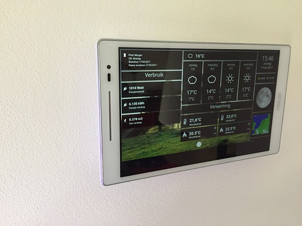

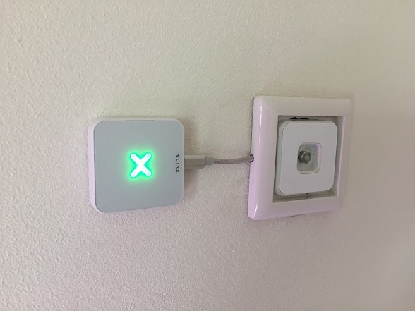

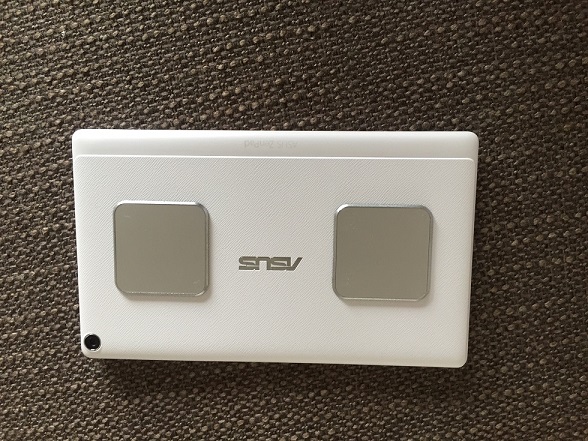

Put the tablet to the wall this weekend :D . I'm using a zenpad 8.0 with a xvida qi charger and some adjusted xvida mounts. Working quite good actually :). It is using magnets and I can remove it very easily.

Great work! Do you have some links for the parts you've used?

Wow... how does it charge?

Blueone wrote:I... with a xvida qi charger
