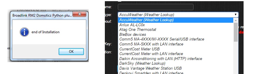

hi. i want test it with windows. i run setup.exe but after install dont add broadlink in hardware.
reza

also for raspberry i want use stable version. can i use this for stable version ?
zak45
Posts: 954
Domoticz version: V2024.4
Re: Python Plugin: Broadlink RM2
Post by zak45 »
reza wrote:also for raspberry i want use stable version. can i use this for stable version ?
yes , can be used from plugin POV but need beta Domoticz version... worked at home since many weeks without trouble.
And for installation problem please read wiki and forum, lot's of informations has been provided.

i want just use stable version 3.5877 (because i did some change in domoticz and i dont want update this). so can you help me for run this on 3.5877 version ?
i need this plugin very :(
zak45
Posts: 954
Post by zak45 »
reza wrote:i want just use stable version 3.5877 (because i did some change in domoticz and i dont want update this). so can you help me for run this on 3.5877 version ?
Sorry , this need domoticz v3.7xxx or better.
