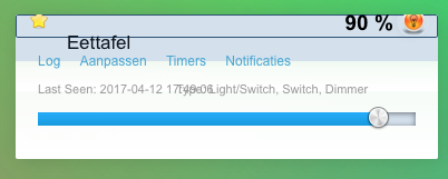

@Bikey, I've been playing around and this is what is the result "last seen". Like it?

All I can say is perfect! :D

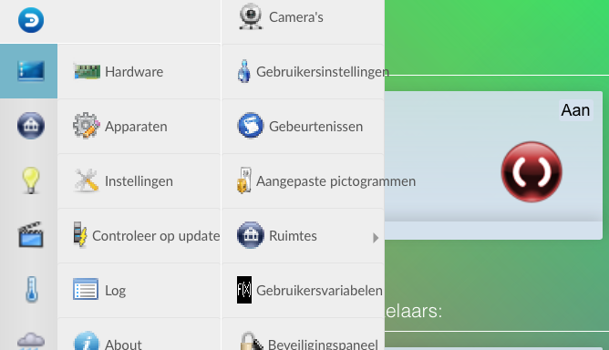

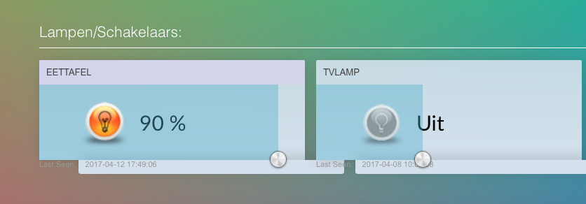

Great work! I tried it (downloaded from the first page).
Unfortunately still some issues (yes, I cleared the cache):

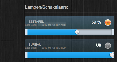

I also downloaded the Feynman Theme from Github, that is really starting to look cool (the dashboard at least) with the transparent switches!
Can't wait to see that theme completely finished across all pages ;-)

Post by EdwinK »
Bikey wrote:Great work! I tried it (downloaded from the first page).
Also have the tings not displayed properly. But it's better then the last version I had.

Post by htilburgs »
Make sure you run the latest beta version of Domoticz.
Try to delete the progress directory completly and then copy the latest version again.
You have to download the GuiWork version from https://github.com/domoticz/domoticz/tr ... es/feynman
Clear cache and try again.
I had the same problem and now its ok.
