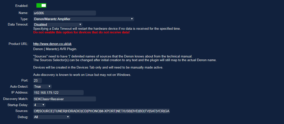

Plugin works like a charm, thx! Is there a way to use the source selection from "Denon - Main Zone" in a scene? When I add "Denon - Main Zone" to a scene it just give me the options: ON/OFF/STOP.
Re: Generic Denon / Marantz python plugin
I am using a Denon AVR-2300W, the correct sourcelist for this receiver is:
OFF|SAT/CBL|DVD|BD|GAME|AUX1|AUX2|MPLAY|TV|TUNER|USB/IPOD|CD|BT|NETHOME|SERVER|IRP
Edit: Not all of them seem to work. Will update list.

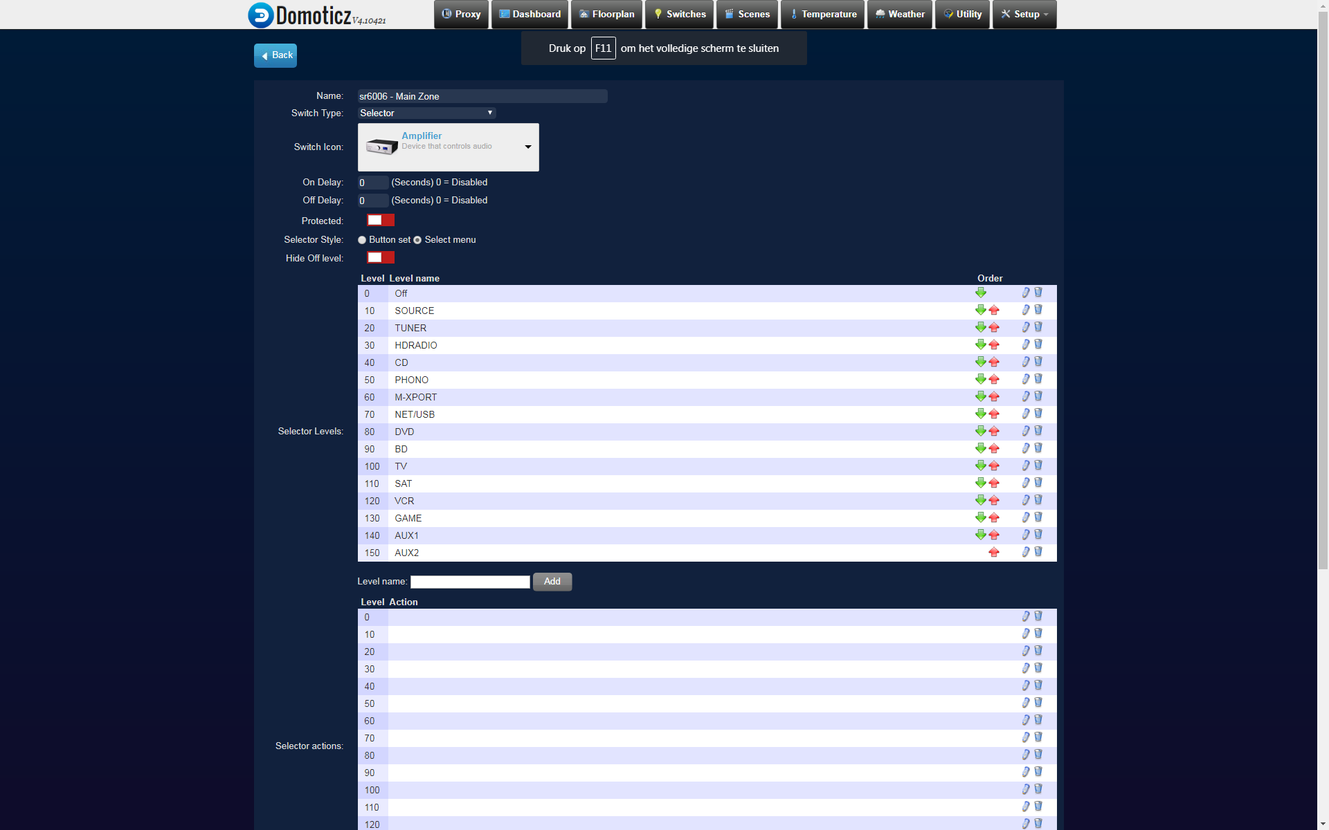

Hi, i want to use this plugin with a marantz sr6006, i installed it in domoticz and now i can only use it to switch power on and off.
The input selector doesnt work correct when i select off the receiver turns off and when i select any of the other options it turns on but other then that it does nothing. i have updated the sourcelist to what i think are the correct values.
What should i do to get this working?
Last edited by savage007 on Monday 11 February 2019 8:22, edited 6 times in total.

I've been looking at the script and when i replace this line in function onCommand :
self.DenonConn.Send(Message='SI'+self.selectorMap[Level]+'\r', Delay=delay)
with :
self.DenonConn.Send(Message='SISAT\r', Delay=delay)
The reciever switches to SAT.
Here's a piece of the log:
2019-02-08 18:32:40.411 Status: User: Admin initiated a switch command (68/sr6006 - Main Zone/Set Level)
2019-02-08 18:32:40.411 Error: (sr6006) 'onCommand' failed 'KeyError'.
2019-02-08 18:32:40.411 Error: (sr6006) ----> Line 450 in '/home/edwin/domoticz/plugins/Domoticz-Denon-Plugin/plugin.py', function onCommand
2019-02-08 18:32:40.411 Error: (sr6006) ----> Line 294 in '/home/edwin/domoticz/plugins/Domoticz-Denon-Plugin/plugin.py', function onCommand
2019-02-08 18:33:08.295 Status: User: Admin initiated a switch command (68/sr6006 - Main Zone/Set Level)
2019-02-08 18:33:08.308 Error: (sr6006) 'onCommand' failed 'KeyError'.
2019-02-08 18:33:08.308 Error: (sr6006) ----> Line 450 in '/home/edwin/domoticz/plugins/Domoticz-Denon-Plugin/plugin.py', function onCommand
2019-02-08 18:33:08.308 Error: (sr6006) ----> Line 294 in '/home/edwin/domoticz/plugins/Domoticz-Denon-Plugin/plugin.py', function onCommand
2019-02-08 18:33:14.144 Status: User: Admin initiated a switch command (68/sr6006 - Main Zone/Set Level)
2019-02-08 18:33:14.182 Error: (sr6006) 'onCommand' failed 'KeyError'.
2019-02-08 18:33:14.182 Error: (sr6006) ----> Line 450 in '/home/edwin/domoticz/plugins/Domoticz-Denon-Plugin/plugin.py', function onCommand
2019-02-08 18:33:14.182 Error: (sr6006) ----> Line 294 in '/home/edwin/domoticz/plugins/Domoticz-Denon-Plugin/plugin.py', function onCommand
2019-02-08 18:33:19.393 Status: User: Admin initiated a switch command (68/sr6006 - Main Zone/Set Level)
2019-02-08 18:33:24.838 Status: User: Admin initiated a switch command (68/sr6006 - Main Zone/Set Level)
2019-02-08 18:33:24.876 Error: (sr6006) 'onCommand' failed 'KeyError'.
2019-02-08 18:33:24.876 Error: (sr6006) ----> Line 450 in '/home/edwin/domoticz/plugins/Domoticz-Denon-Plugin/plugin.py', function onCommand
2019-02-08 18:33:24.876 Error: (sr6006) ----> Line 294 in '/home/edwin/domoticz/plugins/Domoticz-Denon-Plugin/plugin.py', function onCommand
with :

- Dnpwwo
- Posts: 820
- Joined: Sunday 23 March 2014 9:00
- Location: Melbourne, Australia
@savage007,
What have you specified in the 'Source' paramater on the hardware page?
My guess would be that you have not told the plugin that 'SAT' is a device you use.
savage007
- Posts: 19
- Joined: Sunday 13 September 2015 20:24
I can see the plugin tries to send a command to switch to level 110 which is SAT but it fails with : 'onCommand' failed 'KeyError'
2019-02-11 11:02:15.906 (sr6006) Pushing 'onCommandCallback' on to queue
2019-02-11 11:02:15.936 (sr6006) Processing 'onCommandCallback' message
2019-02-11 11:02:15.936 (sr6006) Calling message handler 'onCommand'.
2019-02-11 11:02:15.936 (sr6006) onCommand called for Unit 2: Parameter 'Set Level', Level: 110
2019-02-11 11:02:15.905 Status: User: Admin initiated a switch command (68/sr6006 - Main Zone/Set Level)
2019-02-11 11:02:15.936 Error: (sr6006) 'onCommand' failed 'KeyError'.
2019-02-11 11:02:15.936 Error: (sr6006) ----> Line 450 in '/home/edwin/domoticz/plugins/Domoticz-Denon-Plugin/plugin.py', function onCommand
2019-02-11 11:02:15.936 Error: (sr6006) ----> Line 295 in '/home/edwin/domoticz/plugins/Domoticz-Denon-Plugin/plugin.py', function onCommand
2019-02-11 11:02:17.786 (sr6006) Pushing 'onHeartbeatCallback' on to queue
2019-02-11 11:02:17.794 (sr6006) Processing 'onHeartbeatCallback' message
2019-02-11 11:02:17.794 (sr6006) Calling message handler 'onHeartbeat'.
2019-02-11 11:02:17.794 (sr6006) onHeartbeat called, last response seen 0 heartbeats ago.
2019-02-11 11:02:17.794 (sr6006) Pushing 'WriteDirective' on to queue
2019-02-11 11:02:17.794 (sr6006) onHeartbeat: self.lastMessage Z3, Sending 'TP'.
2019-02-11 11:02:17.794 (sr6006) Processing 'WriteDirective' message
2019-02-11 11:02:17.794 (sr6006) Sending 6 bytes of data
2019-02-11 11:02:17.794 (sr6006) 54 50 41 4e 3f 0d .. .. .. .. .. .. .. .. .. .. .. .. .. .. TPAN?.
2019-02-11 11:02:17.820 (sr6006) Pushing 'ReadEvent' on to queue
2019-02-11 11:02:17.845 (sr6006) Processing 'ReadEvent' message
2019-02-11 11:02:17.845 (sr6006) Received 7 bytes of data
2019-02-11 11:02:17.845 (sr6006) 54 50 41 4e 41 31 0d .. .. .. .. .. .. .. .. .. .. .. .. .. TPANA1.
2019-02-11 11:02:17.845 (sr6006) Pushing 'onMessageCallback' on to queue
2019-02-11 11:02:17.845 (sr6006) Processing 'onMessageCallback' message
2019-02-11 11:02:17.845 (sr6006) Calling message handler 'onMessage'.
2019-02-11 11:02:17.845 (sr6006) onMessage called with Data: 'TPANA1'
2019-02-11 11:02:17.845 (sr6006) TPAN received. Key: 0, Detail A1
2019-02-11 11:02:19.631 (sr6006) Pushing 'onCommandCallback' on to queue
2019-02-11 11:02:19.649 (sr6006) Processing 'onCommandCallback' message
2019-02-11 11:02:19.649 (sr6006) Calling message handler 'onCommand'.
2019-02-11 11:02:19.649 (sr6006) onCommand called for Unit 2: Parameter 'Set Level', Level: 100
2019-02-11 11:02:19.630 Status: User: Admin initiated a switch command (68/sr6006 - Main Zone/Set Level)
2019-02-11 11:02:19.649 Error: (sr6006) 'onCommand' failed 'KeyError'.
2019-02-11 11:02:19.649 Error: (sr6006) ----> Line 450 in '/home/edwin/domoticz/plugins/Domoticz-Denon-Plugin/plugin.py', function onCommand
2019-02-11 11:02:19.649 Error: (sr6006) ----> Line 295 in '/home/edwin/domoticz/plugins/Domoticz-Denon-Plugin/plugin.py', function onCommand
These are the sources aivailable to the receiver :
formMainZone_MainZoneXml.xml :
<?xml version="1.0" encoding="ISO-8859-1"?>
<item>
<Power>
<value>STANDBY</value>
</Power>
<ZonePower>
<value>OFF</value>
</ZonePower>
<InputFuncList>
<value>SOURCE</value>
<value>TUNER</value>
<value>HDRADIO</value>
<value>CD</value>
<value>PHONO</value>
<value>M-XPORT</value>
<value>NET/USB</value>
<value>DVD</value>
<value>BD</value>
<value>TV</value>
<value>SAT</value>
<value>VCR</value>
<value>GAME</value>
<value>AUX1</value>
<value>AUX2</value>
</InputFuncList>
<RenameSource>
<value/>
<value>TUNER </value>
<value/>
<value>CD </value>
<value>PHONO </value>
<value>M-XPort </value>
<value>NET/USB </value>
<value>DVD </value>
<value>BD </value>
<value>TV </value>
<value>SAT </value>
<value>VCR </value>
<value>GAME </value>
<value>AUX1 </value>
<value>AUX2 </value>
</RenameSource>

- Naamloos1.png (31.51 KiB) Viewed 2911 times
- Naamloos.png (127.59 KiB) Viewed 2912 times
savage007
- Posts: 19
I found this somewhere : A 'KeyError' normally means that the plugin has accessed a non-existent Key in a Dictionary.
@Dnpwwo : This is actualy a quote from you
What does this mean for the script?
Is the dictionary the sources list? ( Off|SOURCE|TUNER|HDRADIO|CD|PHONO|M-XPORT|NET/USB|DVD|BD|TV|SAT|VCR|GAME|AUX1|AUX2 )
savage007
- Posts: 19
This is weird, i copied your script from github and pasted in plugin.py, saved it and updated the device in domoticz.
Now it works, no more errors!
- Dnpwwo
- Posts: 820
Very strange indeed.
Glad you got it sorted.
