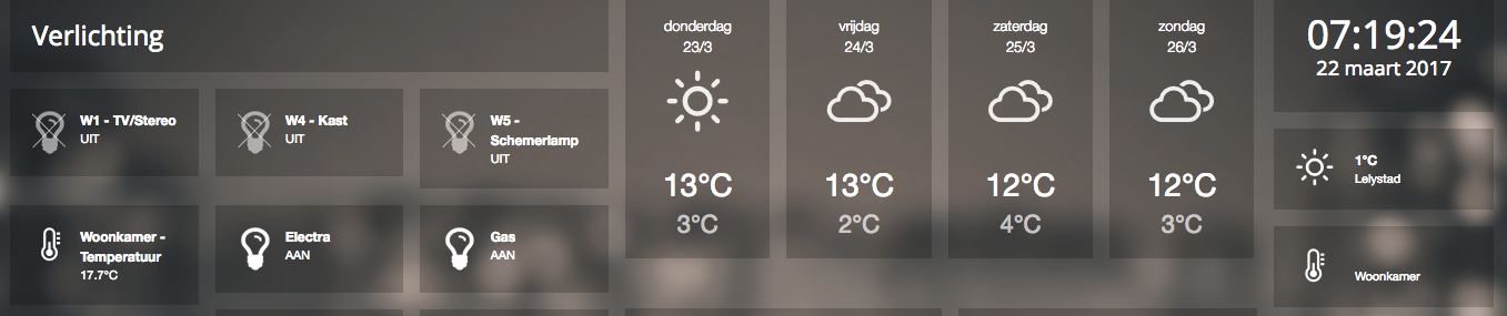

Re: New Dashboard Design
Post by stlaha2007 »
Perhaps the original file had another Type.... Its just below Energy and Gas !!
A screenshot of it expanded with more energy and Woonkamer:
