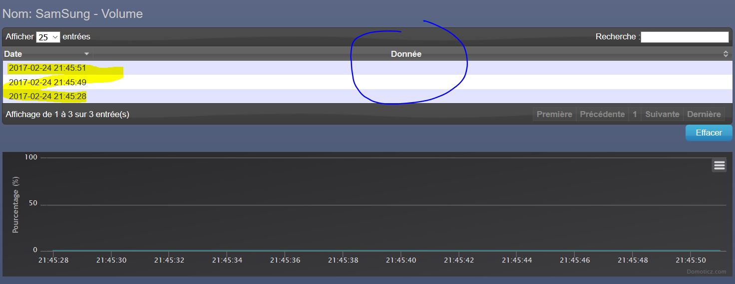

So...
Here are my findings:
when the devices are disconnected, the onCommand is executed delayed and even sometimes never...
but when devices are connected: response time is immediate, which is great !!!
- Spoiler: show
- Spoiler: show
- Capture.JPG (80.58 KiB) Viewed 2973 times

Re: Python Plugin Beta testers - please read this
After removed HW, restart service, re-create HW: all is working on 3.6784 except still no data in log.
Thanks a lot.
