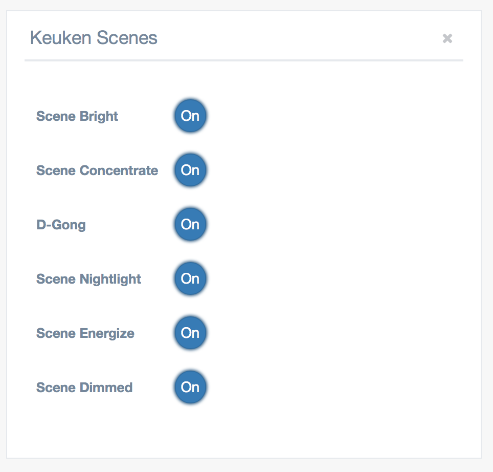

here is an screenshot with the pushon button with D-Gong for example.
Screen Shot 2017-01-02 at 22.05.50.png (96.08 KiB) Viewed 3256 times

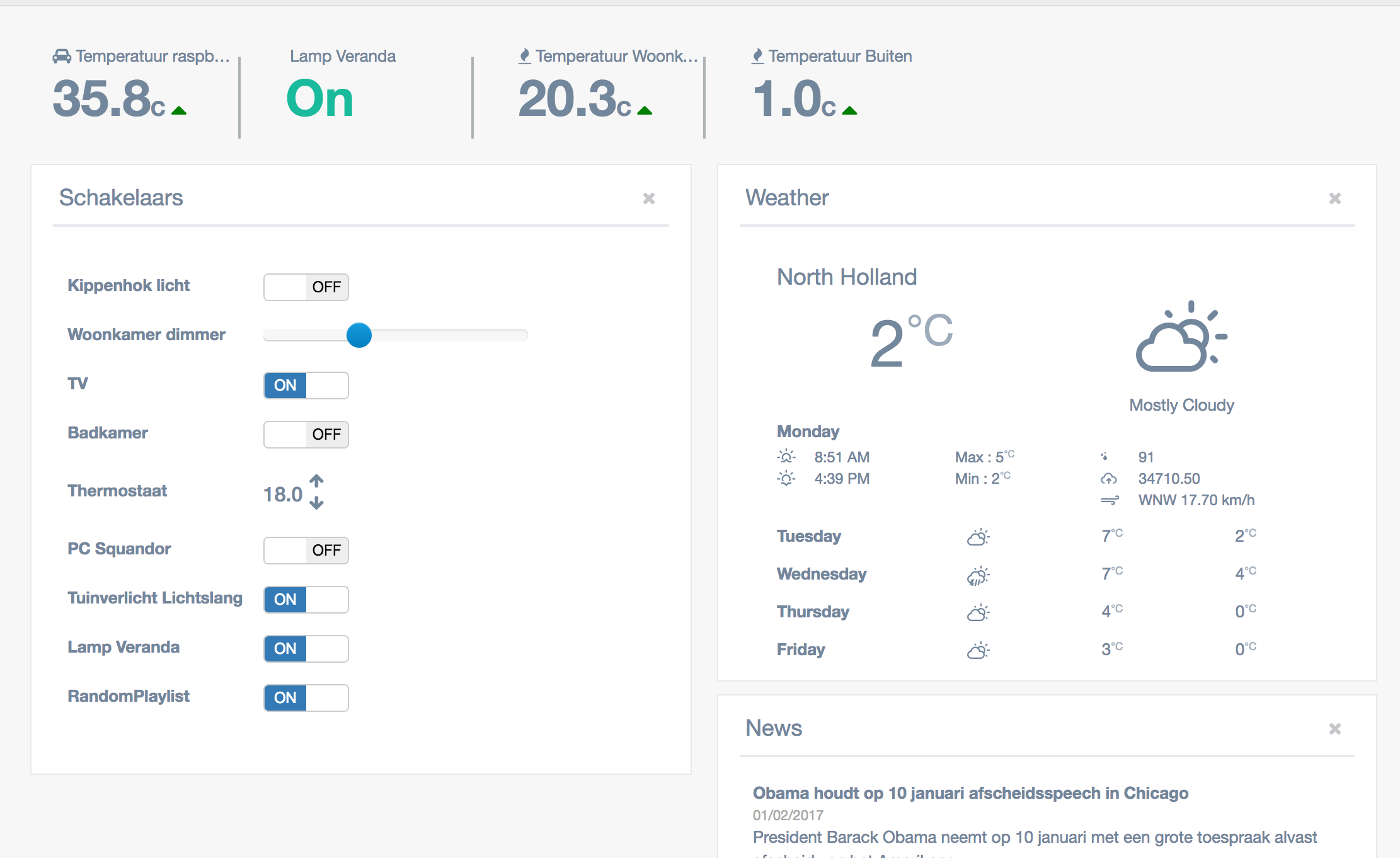

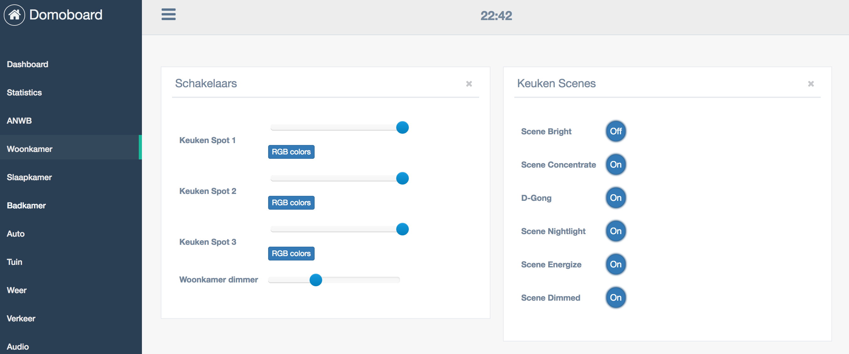

okay here are some pics from my test situation
Screen Shot 2017-01-02 at 22.44.34.png (249.62 KiB) Viewed 3246 times
Screen Shot 2017-01-02 at 22.42.38.png (243.26 KiB) Viewed 3246 times
Screen Shot 2017-01-02 at 22.42.22.png (277.98 KiB) Viewed 3246 times

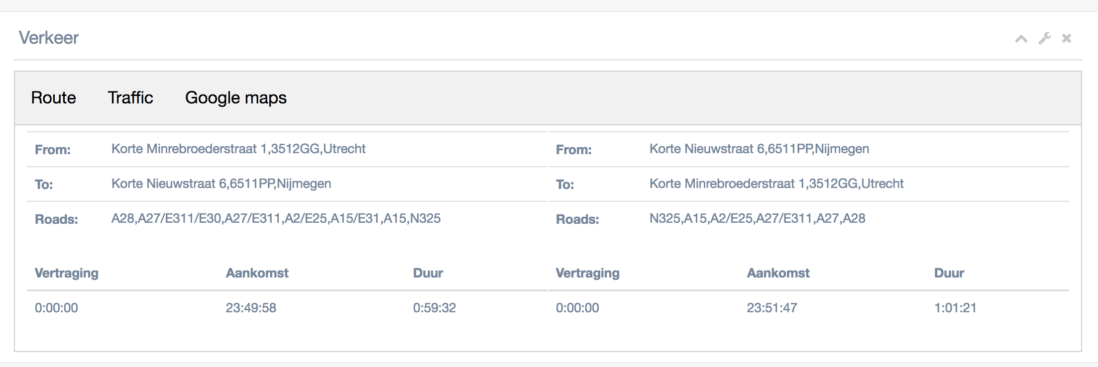

and my traffic and cams obviously
Screen Shot 2017-01-02 at 22.50.27.png (120.5 KiB) Viewed 3245 times
Screen Shot 2017-01-02 at 22.46.33.png (126.56 KiB) Viewed 3245 times
