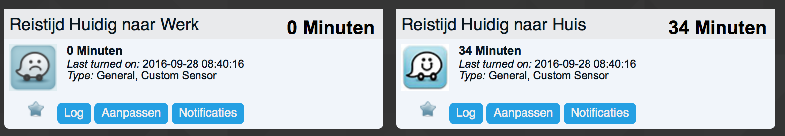

I implemented this script, and I store my coordinates in a custom Text sensor.
In my Waze script (viewtopic.php?f=23&t=7777) I use these coordinates to calculate the travel time from my current location to home and work. Now I can easely see how long my expected travel time will be.
