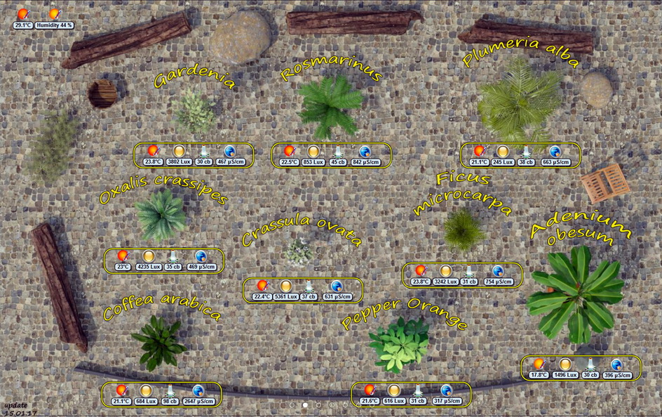

Also, I'm having a hard time keeping the fertility/conductivity over 500, can anyone offer some advice on this?
I use fertilizer when watering - http://www.biobizz.com/home/?lang=enuk
my gardenia blooms already 3 times this year
I've got quite a few tree ferns growing, some better than others, but the Xiaomi monitored ones are not doing the best (going ok but just not growing fast)
are you keeping your plants over 500 points?
yes, I try to keep within 400 - 2000, but for each plant its own parameters, looking in the Flower Care app of knowledge
