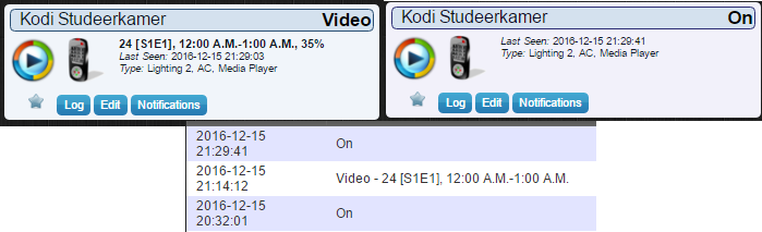

sincze
Posts: 1302
Domoticz version: 2024.4
Re: LUA Pass2php
Post by sincze »
Mmm $s not displaying the actual data, so it seems.
For testing purposes I retrieve the status of a KODI player..
        $status1=($s['Kodi Studeerkamer']);
        $status2=($s['Kodi Woonkamer']);
        $status3=($s['Kodi Keuken']);
        $status4=($s['Kodi Slaapkamer']);
After that I print the results using lg(); so the domoticz log says:
2016-12-15 21:25:37.109 => Kodi Status Studeerkamer: Off
2016-12-15 21:25:37.112 => Kodi Status Woonkamer: Off
2016-12-15 21:25:37.115 => Kodi Status Keuken: On
2016-12-15 21:25:37.118 => Kodi Status Slaapkamer: Off
However Domoticz says:
What am I missing? I want to use this in the following way.
if($s['Kodi Studeerkamer']!="Off")
 curl("http://$ip:$port/jsonrpc?request={%22jsonrpc%22:%222.0%22,%22method%22:%22Addons.ExecuteAddon%22,%22params%22:{%22addonid%22:%22script.securitycam%22},%22id%22:%221%22}}");
This will show a live feed of the IP camera on my Kodi machine :D
But yeah... first it should see the Kodi machine as on, otherwise the function does not work ofcourse :o

You have 2 devices with exactly the same name, only one value is stored in the array. Rename one to for ex StudeerKamer (capital K) and it'll be ok.

Egregius wrote:You have 2 devices with exactly the same name, only one value is stored in the array. Rename one to for ex StudeerKamer (capital K) and it'll be ok.
This is a cleaner url example for kodi:
http://192.168.2.7:1597/jsonrpc?request={"jsonrpc":"2.0","id":1,"method":"Player.Stop","params":{"playerid":1}}
[/quote]
Hahaha sorry.
That is exactly the same device (look at the time stamp below the name) :D
It was just to show the device is working in Domoticz :D (left device is on, right device is playing a video), however the php code says it is off. Clearly not 100% true :o
[/quote]

Well, the $s array comes from Domoticz, I have no control over that.
But, if you have 2 devices with the same name it won't work.
This is what happens in that case:
$s['Kodi Studeerkamer']='Video';
$s['Kodi Studeerkamer']='On';
So only the last will be available.
If that's not the right value it's something in Domoticz. I'm sure if you print the status in lua you'll get exactly the same. On my system I've never seen that behavior, alltough there are topics about it on the forum here.

Egregius wrote:Well, the $s array comes from Domoticz, I have no control over that.
Yes I believe it is not an issue with your script.

This is what I retrieve from Domoticz during playback.
   "ActTime" : 1481916666,
   "ServerTime" : "2016-12-16 20:31:06",
   "Sunrise" : "08:42",
   "Sunset" : "16:30",
   "result" : [
         "AddjMulti" : 1.0,
         "AddjMulti2" : 1.0,
         "AddjValue" : 0.0,
         "AddjValue2" : 0.0,
         "BatteryLevel" : 255,
         "CustomImage" : 0,
         "Data" : "A great Movie to Watch (2012), 3%",
         "Description" : "",
         "Favorite" : 0,
         "HardwareID" : 23,
         "HardwareName" : "Kodi",
         "HardwareType" : "Kodi Media Server",
         "HardwareTypeVal" : 55,
         "HaveDimmer" : true,
         "HaveGroupCmd" : true,
         "HaveTimeout" : false,
         "ID" : "0000010",
         "Image" : "Light",
         "IsSubDevice" : false,
         "LastUpdate" : "2016-12-16 20:30:48",
         "Level" : 0,
         "LevelInt" : 0,
         "MaxDimLevel" : 15,
         "Name" : "Kodi Studeerkamer",
         "Notifications" : "false",
         "PlanID" : "0",
         "PlanIDs" : [ 0 ],
         "Protected" : false,
         "ShowNotifications" : true,
         "SignalLevel" : "-",
         "Status" : "Video",
         "StrParam1" : "",
         "StrParam2" : "",
         "SubType" : "AC",
         "SwitchType" : "Media Player",
         "SwitchTypeVal" : 17,
         "Timers" : "false",
         "Type" : "Lighting 2",
         "TypeImg" : "Media",
         "Unit" : 1,
         "Used" : 1,
         "UsedByCamera" : false,
         "XOffset" : "0",
         "YOffset" : "0",
         "idx" : "225"
   "status" : "OK",
   "title" : "Devices"
Retrieve via Domoticz during 'no active player'.

And this from $s
2016-12-16 20:32:35.024 => Kodi Status Studeerkamer: Off
In the code from domoticz i see: "Status" : "On", or "Status" : "Video", that should be $s right??
