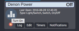

You can add virtual switches in SETUP->HARDWARE menu and select dummy hardware from the list. Name it "Denon" Add.
You now see new hardware "Denon" in the list which has a button "create virtual sensors"
Click on it, select your type... and then add...
Now move over to the SWITCHES menu. Since you can NOT edit sensors in the devices section....
Screen Shot 2016-08-29 at 15.25.46.png (24.49 KiB) Viewed 3763 times

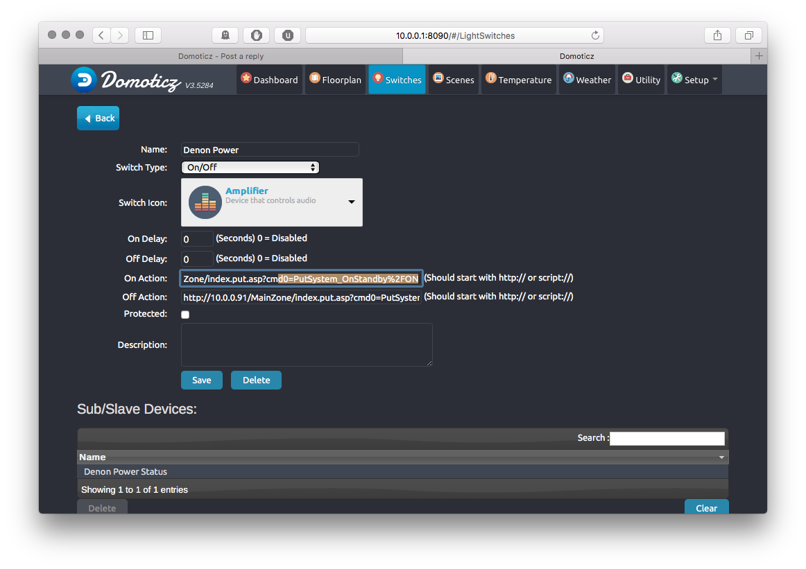

Press edit.. will in the commands...
Screen Shot 2016-08-29 at 15.26.59.png (147.73 KiB) Viewed 3763 times
