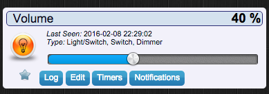

there is no minimum volume parameter, it goes all the way down to mute..
Does your dimmer say Type: Light/Switch, Switch, Dimmer like this:

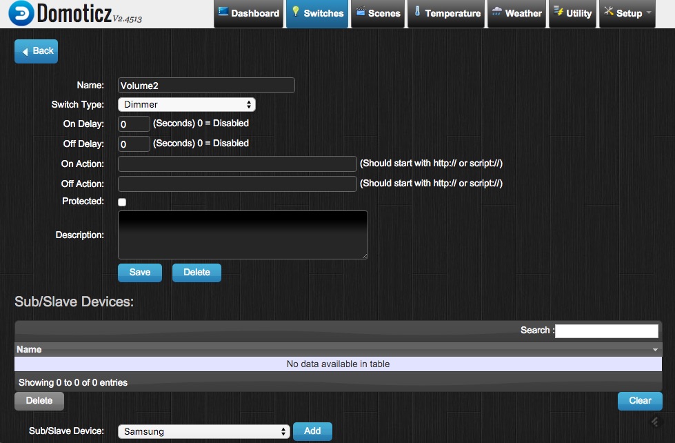

steppi
- Posts: 41
- Joined: Saturday 30 January 2016 0:33
Re: Home Theatre Controller (Pioneer AVR + USB PowerMate)
Yes, I set as dimmer .. below screenshot:
- nayr
- Posts: 354
- Joined: Tuesday 11 November 2014 18:42
- Domoticz version: github
- Location: Denver, CO - USA
the important part im looking for is the: Light/Switch, Switch device, the previous hardware came up as Lighting2, Switch or something similar.
It was limited to 16 steps (0-15) so I suspect your dummy switch is the wrong type, and thats why you cant get past 16%..
If you created the hardware first then upgraded Domoticz to the new version with support I think you'll need to delete the existing switch and create a new one to get it to be the correct type.

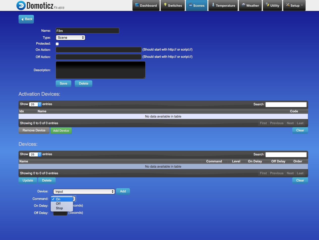

nayr perfect! Now everything works perfectly! The volume is great!
Now I would like to perfect the scenes:
I would like a scene like this:
- Turn Pioneer
- Select Kodi (input)
- Volume to 50% (for example)
- Accnedi Samsung TV (we can also do it with HDMI-CEC - I work there ..)
- Turn off the lights (Philips hue - ok..quello works)
If I try to add a scene I do not have the possibility to decide which inputs to select ..
screenshot: Thanks for everything! and greetings from Italy, here today it's sunny !!
- Turn Pioneer
- nayr
- Posts: 354
Your going to have to accomplish that via Blocky or Lua script, Scenes dont support selector switches at this time.
I provided a lua script above for setting audio modes depending on what input is being used.. you could do something similar with that.
If you really want a scene I think the work around is to create a single dummy switch give it a name starting with a $ to hide it, add it to your scene, and use its on/off state to trigger an event script to perform your actions.. then a Z-Wave scene controller could activate the scene or you can do it manually with the button.

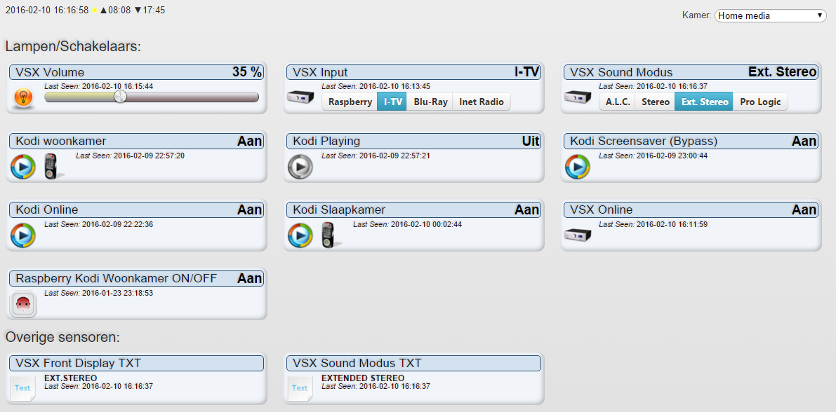

I use the VSX online ping switch to do a extra control if we are home or not.
It sucks when your alone and your battery is dead from the phone and domoticz think we are not home and turn everything off.

ah well good thing I checked that, perhaps I should check all the switches to make sure they are the right type..
How is it doing recovering from your AVR dropping off the network and coming back?
Looks good, you should be able to setup Zone 2 now if you like..
Look at the GeoFencing apps, if you have decent GPS coverage in your house it works better.. but I use a combination of Geofencing, Pinging and each of our devices to decide if the house is really empty or not.. its not perfect but Im working on it.
Are you using Zwave? I wonder if something like a Z-Wave lamp module with load sensing might give you the ability to power on/off.
Looks like your running a KodiPlayer on a RPi, you might take a hard look at the AndroidTV Nexus Player, its a great lil Kodi box and you can root it.. I got mine for like $50 and use a OTG Ethernet.. you get android app support and thats really nice.. I run plex and the native launcher but you can replace the google launcher with Kodi and go right into it.. comes with a bluetooth remote and voice search.
Ive been trying to get the Domoticz Android apps to take on the AndroidTV UI.. no love so far but I might just do it my self
