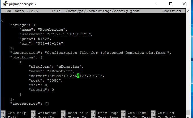

My config.json is under /home/pi/.homebridge/config.json
"bridge": {
"name": "Homebridge",
"username": "CC:21:3E:E4:DE:33",
"port": 51826,
"pin": "031-45-154"
"description": "Configuration file for (e)xtended Domoticz platform.",
"platforms": [
"platform": "eDomoticz",
"name": "eDomoticz",
"server": "rich710:[email protected]",
"port": "8080",
"ssl": 0,
"roomid": 0
"accessories": []
"bridge": {
"port": 51826,
"pin": "031-45-154"
"platforms": [
"port": "8080",
"ssl": 0,
"roomid": 0
"accessories": []
Marci wrote:Looks like it hasn't installed then.
sudo npm install -g homebridge-edomoticz
Presuming Domoticz is still configured as per defaults, no auth is required from local host, therefore, try it without the username and password.

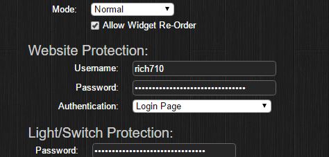

As soon as I enter a username and password as for Website Protection in Domoticz, Homebridge can't connect anymore.
I have entered the right username:pass in config.json. But it always gives me this message:
Sep 21 10:53:28 raspberrypi homebridge[1138]: [9/21/2016, 10:53:28 AM] [eDomoticz] There was a problem connecting to Domoticz.
pi@raspberrypi:~ $
If I leave the user/pass in Domotics blank, Everything works fine, but I think that is not secure, and I will be able to control it outside my LAN.
any hints?

Oh wow! Have just fixed the issue with Authorization, the credentials were not sent properly.
This bug is fixed on the mqtt-integration branch! Be sure to update to that one.
