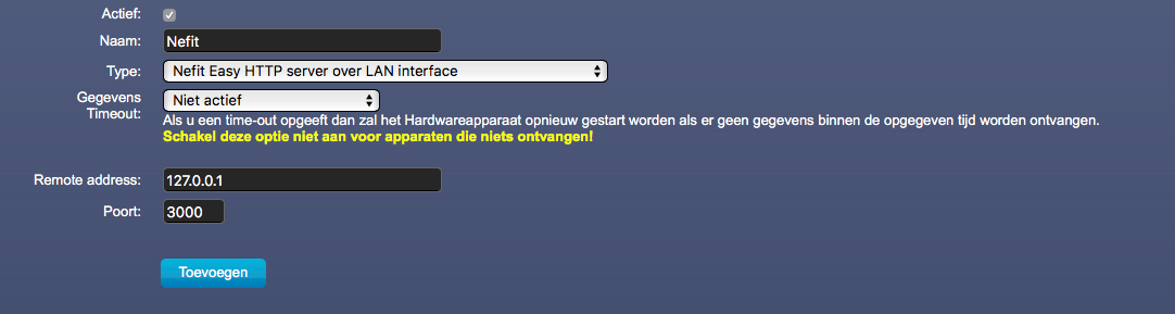

Hi All,
I have running on my Synology Domoticz (2020.2 build 12626) and in Docker I have running the Nefit Easy Server (the pre-made one, from balk77).
Filled in the serialnumber/password/acceskey and that works perfectly. Standard 127.0.0.1 and port 3000.
I fill in Domoticz the information for the server (see screenshot) but I don't see (also not after a few minutes) the nefit pear in Devices.
What do I wrong in your opinion?

Hi, @King1987
What is the real IP Address of your Synology Domoticz and the real IP Address of your Docker container with the Nefit Easy Server?
As long as they are different, you cannot use the local loop-back address 127.0.0.1, but you should use the real IP Address of your Docker container with the Nefit Easy Server.

Sorry, very late reply, but busy times.FireWizard wrote: ↑Wednesday 11 November 2020 20:02 Hi, @King1987
You mean that I need to put a ip adres in the range of my Docker? The Docker container is running also on my Synology, so Domoticz and Docker are on the same system.
My IP range is different then 127.0.0.1 (it is in the 192.168 range). Or is the not what you mean?

Hi, @King1987,
You wrote:
This means that, even if they are physically on the same hardware Domoticz (and the Synology NAS) and Docker are on different networks.
See: https://docs.docker.com/config/containe ... etworking/
You wrote:
Yes, use the IP address and not 127.0.0.1. Your docker container is not on the same network as the host (Synology).You mean that I need to put a ip adres in the range of my Docker? The Docker container is running also on my Synology, so Domoticz and Docker are on the same system.
