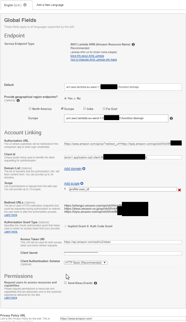

I have a problem with discovery new devices on alexa. Everything is set up properly. The Lambda i working correctly because i can turn on lights from it. The Skill App is on language English (U.K.) and the app is on EU (Ireland)
Can somebody Healp me. What I'm missing
Configuration of the skill:

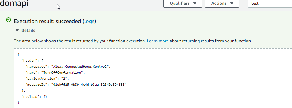

Succed test on Lambda:

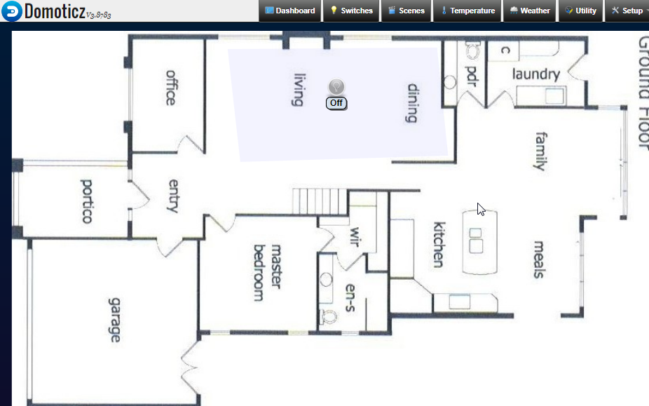

Domoticz room plan Very Simple:
Device is zwave RGBW switch

There is an aggressive timeout for device discovery. It's been a while since I last paid attention but I seem to recall having to play some tricks to make discovery faster. Is the invocation timing out? Check the CloudWatch logs for your Lambda function and see what's happening...

The lambda cloudWatch show nothing except my last text from lambda to domoticz. There is no logs for trying to connect from alexa to lambda

check the trigger from the skill to the lambda is enabled - try deploying it to a lambda in Virginia. If the code works directly from the lambda, but not from Alexa or the app, then it's the skill, not the lambda.

Yes the app is working from lambda to domoticz. Skill is not working from alexa to lambda and I don't know why :( The config is as in your pdf maybe something was changed already

can you try running it from Virginia and removing references to the Ireland lambda?
