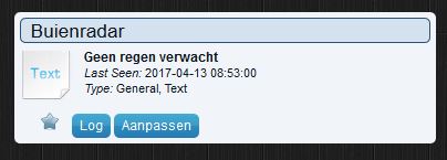

EdKo66 wrote:
axelbaas wrote: Hmm.. Mine is shown as a normal switch..
Tried both Text and Light/switch;
IsItGonnaRain	     General	        Text	        Geen regen verwacht binnen komende 15 minuten
Regen verwacht	     Light/Switch	Switch	Off
Is it one of the scripts on this page? https://www.domoticz.com/forum/viewtopi ... =38&t=5903
Yes. I used the script somewhere on page 5.
Sorry for the late reaction, but yes thats the script. I removed the part wich said "binnen 15 minuten".
Also in my domoticz its a text idx (53) not a switch.

SwordFish wrote:
Got it working, sort of ;)
Only the wrong icon, could you send me the output of this device?
