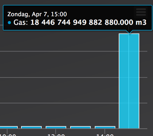

I have huge spike in my nefit gas-usage graphs ... deleting the entry with shift-click does not work ... Looks like some counter did roll-over or something like this.
This happens a couple of times per month, so in the end the totals and the graphs are unusable.
Is there some way to fix this ?
like (if entry > average last 24h {set entry to (average last 24h)} ?
Eddie

I have a similar incorrect Spike also on Sunday. Its just not Nefit related. Its on my zwave Fibaro plug that monitors my fridge.
Almost 2.7 Million kWh in 1 day.
