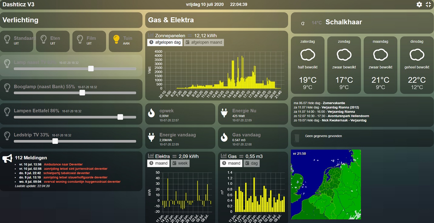

Ik having a problem with Garbage collector in Dashticz v3.
i use the code beneath and only get a empty window.
what am i doing wrong?

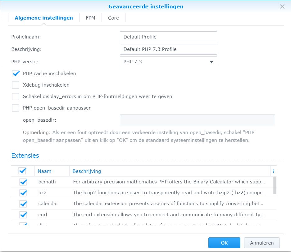

Maybe your PHP setup is not correct.
Did you install Dashticz on a Synology? On your Nas, PHP settings, did you enable the 'curl' and 'openssl' PHP extensions?
NilsNijenhuis
- Posts: 81
- Joined: Friday 10 July 2020 22:56
Re: Dashticz - Module - Garbage collector
I have got a Symology NAS (DS213) with php 7.3 installed (see print screen) and curl and every other possibility enabled

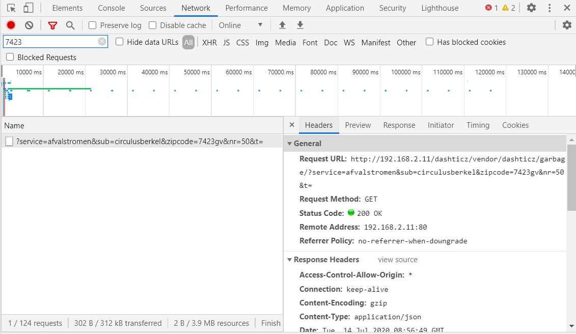

NilsNijenhuis
- Posts: 81
see the print screen below @lokonli
is that what you need?
- reply.JPG (93.78 KiB) Viewed 2435 times
Lokonli
- Posts: 2296

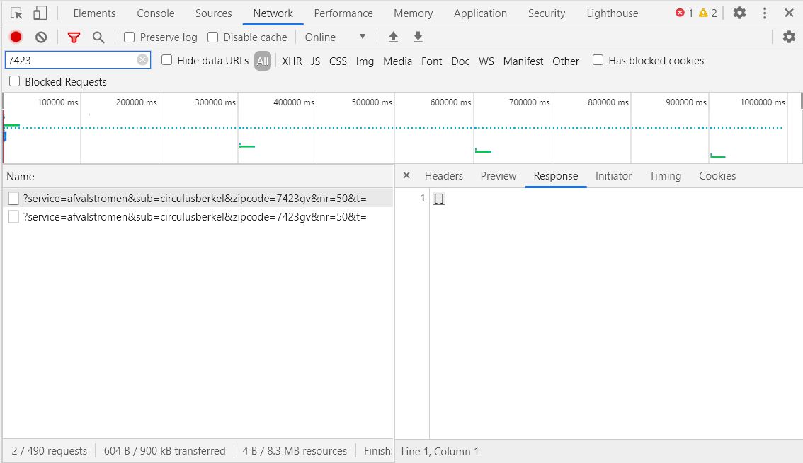

The status code is 200 which is ok. Can you also click on response and show the result?
NilsNijenhuis
- Posts: 81
- response.JPG (74.56 KiB) Viewed 2414 times
Lokonli
- Posts: 2296
The response is empty. I dont know why. I will double check again on my system later this week.

When i press F12 (in Chrome) to open DevTools.mojojojo490 wrote: Wednesday 15 July 2020 17:25 The online site info gives the information, but the collector won't...
The result in red is:
<br />
<b>Warning</b>: Invalid argument supplied for foreach() in <b>/var/www/html/vendor/dashticz/garbage/index.php</b> on line <b>43</b><br />
[]Code: Select all
foreach($return as $row){
[UPDATE 20:23h] when i follow the json link: http://json.mijnafvalwijzer.nl/?method= ... nummer=106 then the output = "NOK"
When i try the zipcode from a earlier comment on this tread (from mijnafvalwijzer.nl), then i get json info..... So i will contact AddComm for more info.
