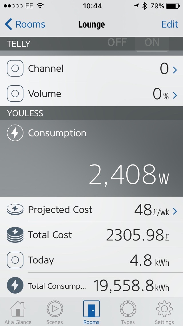

MikeF
Posts: 350
Domoticz version: V2022.2
Location: UK
Re: homebridge-edomoticz Plugin
Post by MikeF »
MikeF wrote:
it would be good if Pressure (from BMP180 / BME280 devices) was recognised by Eve.
Sorry, I wasn't clear here - Eve does recognise my pressure devices, it's just that they display with the (HomeKit) unrecognised type icon:
Is it worth raising a GitHub issue for this?
Today consumption displaying OK in Eve - but with unrecognised type icon.
