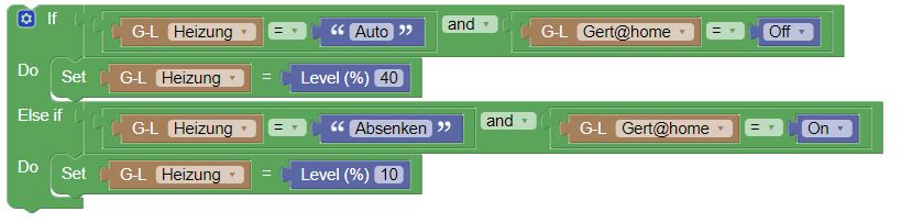

I don´t know, why my blockly script doesn´t work?
"Heizung" is a selector-switch:
and "Gert@home" is a normal on/off-switch
[email protected] (39.01 KiB) Viewed 7464 times
Hope that someone can help??

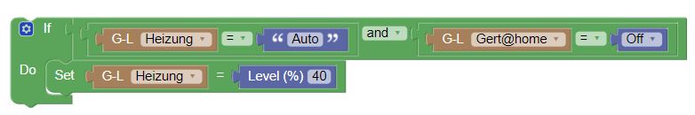

Gertschi wrote: Wednesday 06 February 2019 16:12 Hello,
[email protected]
With only 1 if statement, you can only use the If-blockly WITHOUT the blue gear icon. When using the one WITH the icon, you HAVE to use else if's

I also used this, with no luck???

Has anyone run a blockly script that has linked a "and/or" block to a selector switch in an if-statement???
After a whole day try and error, I think it isn´t possible with blockly??? Because without the selector switch in the if-statement it works.

Gertschi wrote: Wednesday 06 February 2019 17:29 I also used this, with no luck???
This should work just fine, just tested it myself

I found the problem: The selector-switch was the wrongdoer!!!
My selector-switch was created by the ebusd plugin and the 0 Step was the problem.
So I created it manually with my steps and I also created a not possible 0 step...and it worked!!!

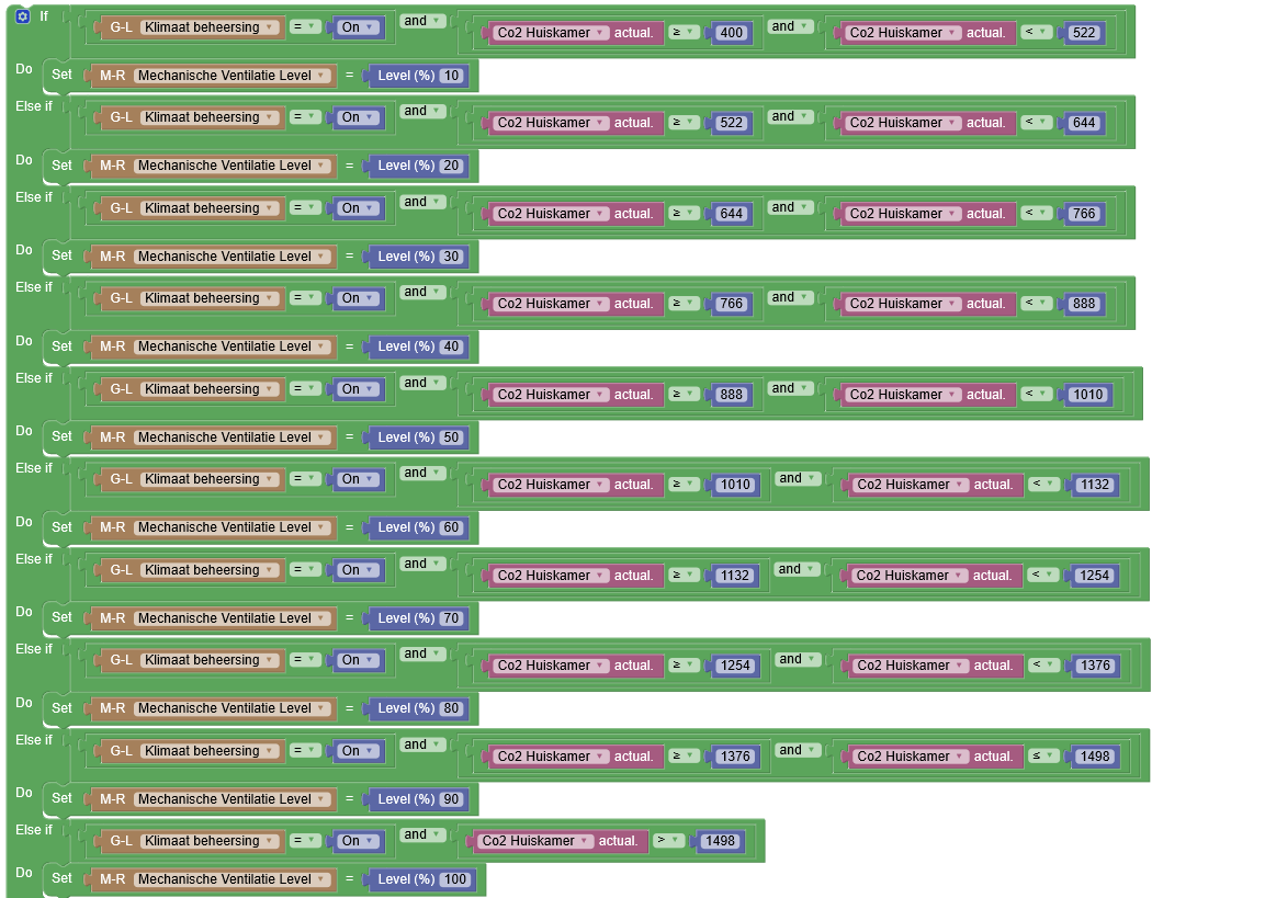

i have a question witch i cant figure out how to solve this.
Made this blocky,
Aantekening 2019-04-25 212422.png (163.85 KiB) Viewed 6880 times
but the "problem" is not how it works because it works perfect for me.
but my device log i growing huge…
every minute it updates to the log.
did some braincracking on this but im just blind to see it.
i hope someone else with a fresh view sees how to tackle this..
greets marco

I'd add a integer variable 'mechanische_ventillatie_level' which I'll sync with the level (%) of the switch so you'll get something like:
If [Klimaat beheersing] = [On] and [CO2 Huiskamer] >= [400] and [CO2 Huiskamer] < [522] and [VAR mechanische_ventillatie_level] ≠ [10]
Do [Set Mechanische Ventillatie Level] = [Level (%) 10]
   [Set [VAR mechanische_ventillatie_level] = [10]
Else if [Klimaat beheersing] = [On] and [CO2 Huiskamer] >= [522] and [CO2 Huiskamer] < [644] and [VAR mechanische_ventillatie_level] ≠ [20]
Do [Set Mechanische Ventillatie Level] = [Level (%) 20]
   [Set [VAR mechanische_ventillatie_level] = [20]
etc
If your switch 'Mechanische Ventillatie Level' is a selector switch, you can skip the variable and just add the name of each level to the if's
This way each (else) if only triggers once when conditions are met

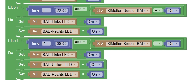

Hello, how can I realize it?
From 22.00 on, I would like to see the lamp on the left and on the right and from 6:00 on the lamp on the left, on the right and on the top.
but it does not work that way

tozzke wrote:I'd add a integer variable 'mechanische_ventillatie_level' which I'll sync with the level (%) of the switch so you'll get something like:
etc
I will try this.
But what I don’t understand is that var has to be 10 to set ventilation to 10 and set var to 10.
In my brain it’s not possible to event start this switch. Because what will set var to 10 in the first time? To even make a switch possible?
Edit: I see... I should use = and ≠ !!

salopette wrote: Friday 26 April 2019 17:05 Hello, how can I realize it?
anyone an idea?

salopette wrote: Saturday 04 May 2019 14:31
anyone an idea?
What exactly doesn't work?
I'd say that you'll have to edit your time settings (and add a safety so it won't keep (re)triggering) so you'll get something like this:
Else if [Time >= [22:00]] and [XiMotion Sensor BAD] = [On] and [ [BAD-Links LED] = [Off] or [BAD-Rechts LED] = [Off] ]*
Do [Set [BAD-Links LED] = [On]]
   [Set [BAD-Rechts LED] = [On]]
Else if [Time >= [6:00]] and [Time < [22:00]] and [XiMotion Sensor BAD] = [On] and [ [BAD-Links LED] = [Off] or [BAD-Untere LED] = [Off] or [BAD-Rechts LED] = [Off] ]*
   [Set [BAD-Untere LED] = [On]]
* mind the blocks regarding the or-statement, all the or's have to be in a composed block which you add to the second part of the previous and-block.

My problem is e.g. that the lights do not come on at 5 o'clock.

salopette wrote: Monday 06 May 2019 20:49 My problem is e.g. that the lights do not come on at 5 o'clock.
Do you want to share your entire Blockly? You shared only a part of it
