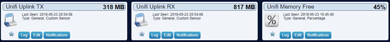

Re: Pass2PHP
A well, because we now can
read the usage of a Unifi AP-AC-LR
