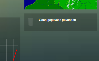

klaaspiet
Posts: 34
Joined: Tuesday 09 January 2018 8:29
Location: Harlingen
Re: Dashticz - Module - Garbage collector
Post by klaaspiet »
Gianni wrote: Monday 09 March 2020 0:04 why do you use double [[
columns[6]['blocks'] = [['garbage']];
Aantekening 2020-03-09 112723.png (20.42 KiB) Viewed 1549 times
this is what i got
config['garbage_company'] = 'omrin';
config['garbage_icalurl'] = 0;
config['google_api_key'] = 0;
config['garbage_calendar_id'] = 0;
config['garbage_zipcode'] = 'xxxxxx';
config['garbage_street'] = 'xxxx';
config['garbage_housenumber'] = 'xx';
config['garbage_housenumberadd'] = 0;
config['garbage_maxitems'] = '3';
columns[3] = {}
columns[3]['blocks'] = [buttons.buienradar,'garbage']
columns[3]['width'] = 2;
Lokonli
Posts: 2292
Post by Lokonli »
klaaspiet wrote: Monday 09 March 2020 11:29
this is what i got
columns[3] = {}
Did you already update to the latest beta? :
git checkout beta
git pull
Can you remove the following line from your CONFIG.js:
Can you send me your zipcode and housenumber by PM, then I'll test tonight.

There was a small bug in the Omrin garbage module for housenumbers > 9.
This has been fixed in latest beta.

It seems that Cure has changed to mijnafvalwijzer.nl.
How do i switch to this new garbage data provider ?
Not Working anymore : https://afvalkalender.cure-afvalbeheer. ... n/5731LB-6
Working (at least i get some json data) : http://json.mijnafvalwijzer.nl/?method= ... isnummer=6
Peer

This one is easy (I hope). Switch to mijnafvalwijzer.nl :)
config['garbage_company'] = 'mijnafvalwijzer';

Hi Lokonli,
Thank you, that made a little fix (i think).
When i connect to /vendor/dashticz/garbage/index.php?service=mijnafvalwijzer&sub=undefined&zipcode=5731LB&nr=6&t=
i get a pretty json response :

But the icon in my dashboard keeps "Loading" ("Laden" in Dutch)
And when i open inspect is see an error about the mapGarbageType :
bundle.js?t=1:26 Uncaught TypeError: Cannot use 'in' operator to search for 'length' in 1
    at isArrayLike (bundle.js?t=1:26)
    at Function.each (bundle.js?t=1:26)
    at mapGarbageType (<anonymous>:456:11)
    at <anonymous>:233:34
    at Array.map (<anonymous>)
    at Object.success (<anonymous>:229:14)
    at fire (bundle.js?t=1:37)
    at Object.fireWith [as resolveWith] (bundle.js?t=1:37)
    at done (bundle.js?t=1:37)
    at XMLHttpRequest.<anonymous> (bundle.js?t=1:37)
Regards Peer
