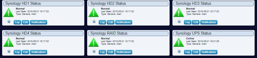

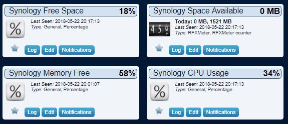

As I had a faulty HD recently in my RAID configuration and was notified by DSM via e-mail I thought I could do better.
Notification via Telegram / Pushover with urgent notice :D
So I created a Pass2PHP function that could retrieve the status of the HD's but also read the status of the UPS and RAID status.
UPS
UPS
Synology Pass2PHP UPS.JPG (60.1 KiB) Viewed 2497 times
In addition I also added the temperature sensors with PHP instead of using the cronjob to do it for me :lol:
https://www.domoticz.com/wiki/NAS_Monitoring

Can you post the function? Sounds interesting :mrgreen:
sincze
Posts: 1302
Domoticz version: 2024.4
Re: Pass2PHP
Post by sincze »
Egregius wrote: Monday 21 May 2018 20:54 Can you post the function? Sounds interesting :mrgreen:
You know I'm not 100% php programmer right so ;-) there will be room for improvement.
function getStringBetween($str,$from,$to)
    $sub = substr($str, strpos($str,$from)+strlen($from),strlen($str));
    return substr($sub,0,strpos($sub,$to));
function snmp_nas()     /* https://global.download.synology.com/download/Document/MIBGuide/Synology_DiskStation_MIB_Guide.pdf    */
    if (status('Synology')=='On')
        $to_snmp = array(
                        array( 'Device' => "Synology HD1 Status", 'Address' => "1.3.6.1.4.1.6574.2.1.1.5.0", 'Type' => "Diskstatus" ),
                        array( 'Device' => "Synology HD2 Status", 'Address' => "1.3.6.1.4.1.6574.2.1.1.5.1", 'Type' => "Diskstatus" ),
                        array( 'Device' => "Synology HD3 Status", 'Address' => "1.3.6.1.4.1.6574.2.1.1.5.2", 'Type' => "Diskstatus" ),
                        array( 'Device' => "Synology HD4 Status", 'Address' => "1.3.6.1.4.1.6574.2.1.1.5.3", 'Type' => "Diskstatus" ),
                        array( 'Device' => "Synology RAID Status", 'Address' => "1.3.6.1.4.1.6574.3.1.1.3.0", 'Type' => "Raidstatus" ),
                        array( 'Device' => "Synology Power Status", 'Address' => "1.3.6.1.4.1.6574.1.3.0", 'Type' => "Status" ),
                        array( 'Device' => "Synology Fan Status", 'Address' => "1.3.6.1.4.1.6574.1.4.2.0", 'Type' => "Status" ),
                        array( 'Device' => "Synology UPS Status", 'Address' => "1.3.6.1.4.1.6574.4.2.1.0", 'Type' => "UPSstatus" ),
                        array( 'Device' => "CpuUser",  'Address' => "1.3.6.1.4.1.2021.11.9.0", 'Type' => "Calculate" ),     // Calculate device only
                        array( 'Device' => "CpuSystem",  'Address' => "1.3.6.1.4.1.2021.11.10.0", 'Type' => "Calculate" ),  // Calculate device only
                        array( 'Device' => "Memtotal",  'Address' => "1.3.6.1.4.1.2021.4.5.0", 'Type' => "Calculate" ),     // Calculate device only
                        array( 'Device' => "MemShared",  'Address' => "1.3.6.1.4.1.2021.4.13.0", 'Type' => "Calculate" ),   // Calculate device only
                        array( 'Device' => "MemBuffer",  'Address' => "1.3.6.1.4.1.2021.4.14.0", 'Type' => "Calculate" ),   // Calculate device only
                        array( 'Device' => "MemCached",  'Address' => "1.3.6.1.4.1.2021.4.15.0", 'Type' => "Calculate" ),   // Calculate device only
                        array( 'Device' => "MemAvailable", 'Address' => "1.3.6.1.4.1.2021.4.6.0", 'Type' => "Calculate" ),  // Calculate device only
                        array( 'Device' => "Synology HD1 Temperature", 'Address' => "1.3.6.1.4.1.6574.2.1.1.6.0" ),
                        array( 'Device' => "Synology HD2 Temperature", 'Address' => "1.3.6.1.4.1.6574.2.1.1.6.1" ),
                        array( 'Device' => "Synology HD3 Temperature", 'Address' => "1.3.6.1.4.1.6574.2.1.1.6.2" ),
                        array( 'Device' => "Synology HD4 Temperature", 'Address' => "1.3.6.1.4.1.6574.2.1.1.6.3" ),
                        array( 'Device' => "Synology System Temperature",  'Address' => "1.3.6.1.4.1.6574.1.2.0" )
        foreach ($to_snmp as $snmp)
            $result = snmp2_get(snmp_ip_nas, snmp_community, $snmp['Address']);   // These results need cleaning ;-)
            if (strpos($result, "Opaque: Float: ") === 0)                         // First remove the floats
                $result = str_replace("Opaque: Float: ","",$result);
                $result = substr($result, 0, strpos($result, "."));
            elseif (strpos($result, 'STRING: "') === 0)                           // THe UPS Status is a string we need to retrieve the data here
                $from = '"';
                $to = '"';
                $result = getStringBetween($result,$from,$to);
                if ($result === "OL") $result = '1:Online';                       // UPS status (OL=on line, OB=on battery, CHRG=charging, DISCHRG=discharging, etc
                elseif ($result === "OB") $result = '3:On battery';
                elseif ($result === "CHRG") $result = '2:Charging';
                elseif ($result === "DISCHRG") $result = '4:Discharging';
                else $result = '0:unknown';
            else $result = preg_replace('/[^0-9]/', '', $result);               // For everything else strip all non Alpha characters so we have only intergers left
            $memory[$snmp['Device']] = $result;                                 // Create a new array with parsed results as we can use this later for calculation
            if (isset($snmp['Type']))                                           // For all devices that report numeric and we want to see a text as well
                switch ($snmp['Type'])
                    case 'Status':                                              // Simple Status Normal / Failed
                        if ($result == 1) $result = '1:Normal';
                        else $result = '2:Failed';
                        break;
                    case 'Diskstatus':                                              // Synology disk status Each meanings of status represented describe below.
                        if ($result == 1) $result = '1:Normal';                       // Normal(1): The hard disk functions normally.
                        elseif ($result == 2) $result = '2:Initialized';              // Initialized(2): The hard disk has system partition but no data.
                        elseif ($result == 3) $result = '3:NotInitialized';           // NotInitialized(3):   The hard disk does not have system in system partition.

Egregius wrote: Tuesday 22 May 2018 17:58 Did you see this pdf of Syno? https://global.download.synology.com/do ... _Guide.pdf
Yes I knew about the document, but I did not know how to use snmpwalk :D
That was untill now.
It seems I need :D
HDTOTAL 1.3.6.1.2.1.25.2.3.1.5.51
HDUSED 1.3.6.1.2.1.25.2.3.1.6.51
Synology Space.JPG (42.7 KiB) Viewed 2440 times
