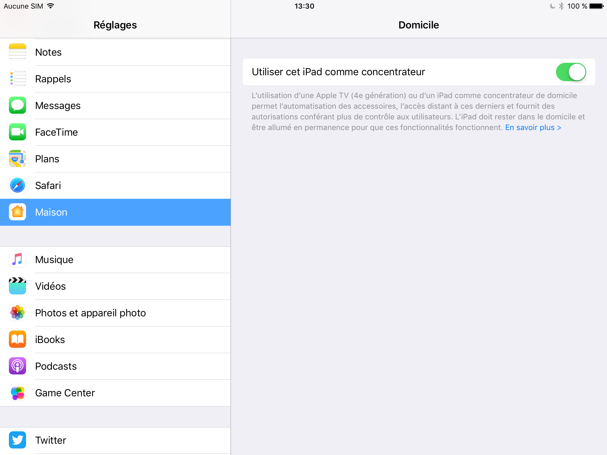

I don't know if you kwon but you can use homekit from outside with apple TV 3 or 4
But also with ipad on ios 10 !!!
And it's ok with edomoticz
- IMG_0103.PNG (198.58 KiB) Viewed 4346 times
