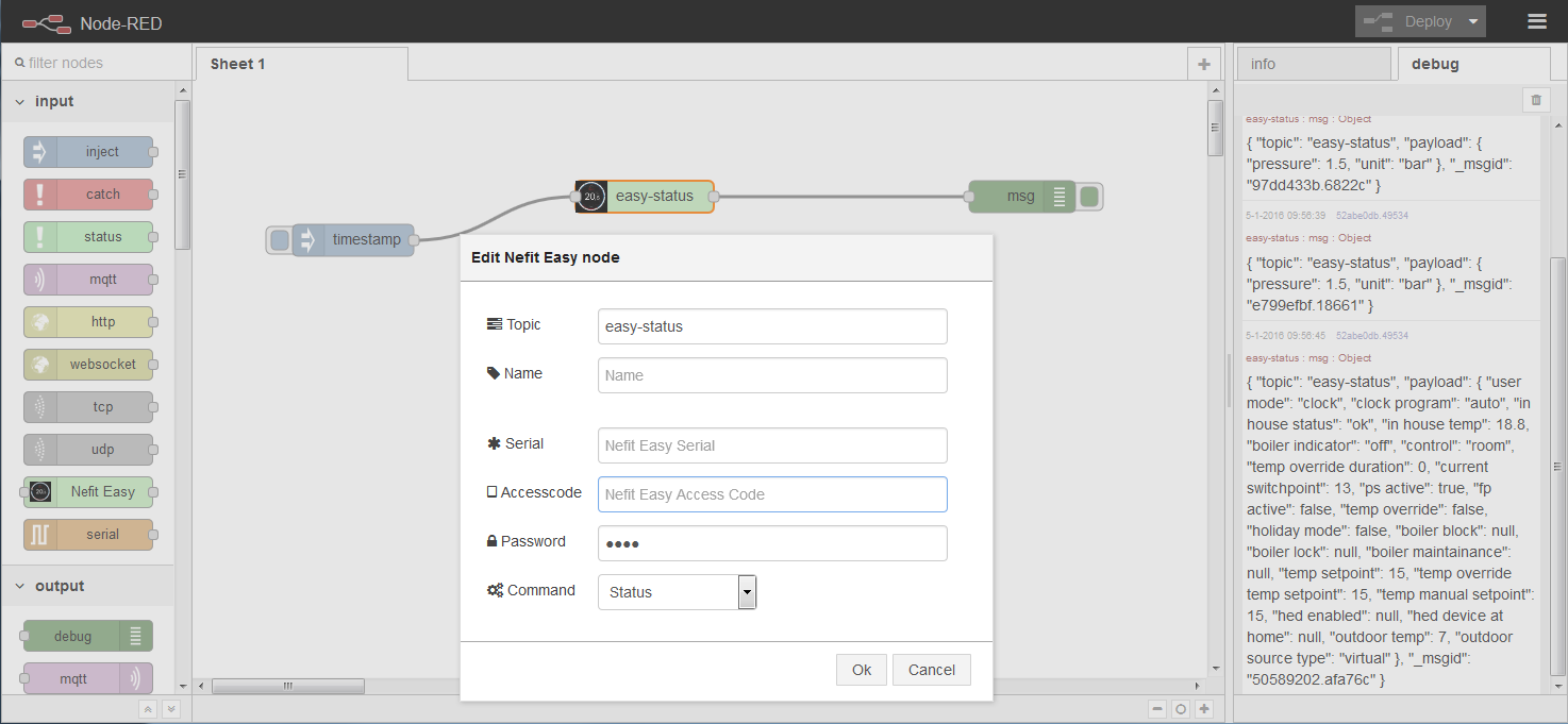

As mentioned before using the scripts is not the way to go.
Right now I'am working on a (native) Node-RED node for Nefit Easy.
Nefit Node.png (74.03 KiB) Viewed 4072 times
As you can see I'am able to communicate to the Easy directly (so without scripts). But the node is not finished yet.
