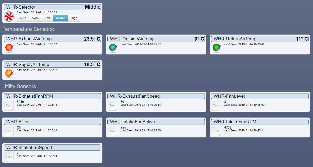

I've made a new script for the WHR930 with MQTT support,
https://github.com/AlbertHakvoort/Stork ... oticz-MQTT
- whr930-domoticz.png (70.14 KiB) Viewed 8025 times
