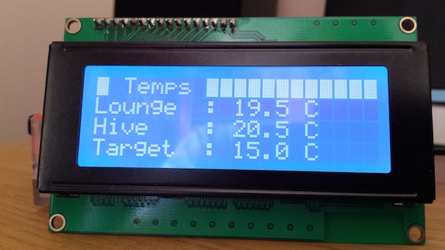

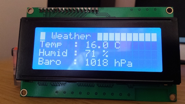

Here are some of the original screenshots, to show what can be achieved (although I can't guarantee they align exactly with the code, as I've changed this quite a lot).

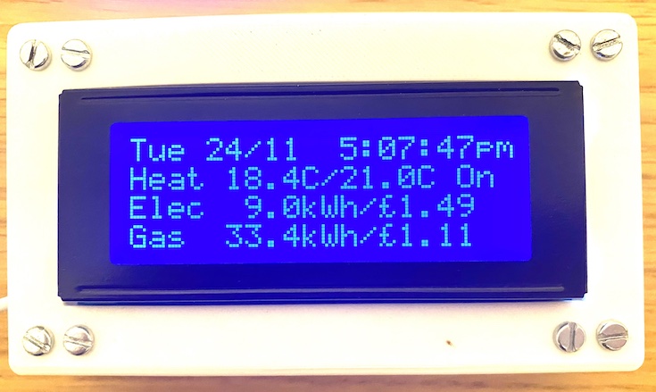

Posted: Tuesday 24 November 2020 18:41
by MikeF
Here's a simpler one-screen example. I'm displaying heating temperatures and electricity / gas usage and cost, from devices I've created in Domoticz.
Decide what info you want to display, and change idx's and lcd_display_string values in domoticzGetValues accordingly.
