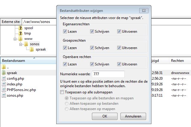

YEEEEEEESSSSS! I'm able to use TTS on a RPI. As you can read Thorjb had some problems. I had the same. This problem exist when you don't use a file share but you use your RPI as place to read and find the MP3 files. I hope G3rard will change the following recommendations in the source files. If not you can do it by yourself after downloading these file ;)
In file sonos.php change line 438
$this->_PHPSonos->SetAVTransportURI('x-file-cifs:' . $this->_config['messagePath'] . $messageId . '.mp3');
to
$this->_PHPSonos->SetAVTransportURI($this->_config['messagePath'] . $messageId . '.mp3');
In file config.php you can find the following lines:
        'messagePath'   		=> '//<yourpath>/sonos/spraak/',
        'messageStorePath'   	=> '//<yourpath>/sonos/spraak/',
If you use a RPI, change to:
        'messagePath'   		=> 'http://xxx.xx.x.xx/sonos/spraak/',  // for f.e. a RPI
        'messageStorePath'   	=> 'http://xxx.xx.x.xx/sonos/spraak/',
xxx.xx.x.xx is the IP adres of you RPI server (Domoticz).
On your RPI excute the command: sudo chmod +777 /var/www/sonos/spraak
If you use a network share change to
        'messagePath'   		=> 'x-file-cifs://<yourpath>/spraak/',     // for network share
        'messageStorePath'   	=> 'x-file-cifs://<yourpath>/spraak/',
Now is EasySonos Easy :D
