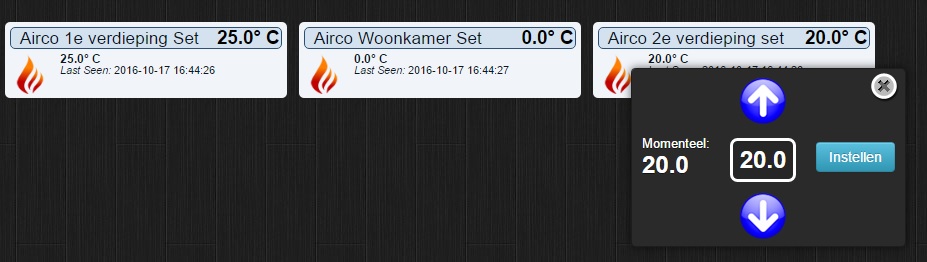

I'm trying to control my Daikin Airco with Domoticz.
However, when I try to set the temperature in the dashboard (see screenshot) the log displays:
2016-10-17 16:46:54.717 User: admin initiated a SetPoint command
But nothing changes on the Airco.
For the record, I'm using Domoticz on WIndows.
Can anyone explain this or help me?

Re: Daikin integration
@Globalassist. Native Daikin intergration is still a work-in-progress. For now it's read-only for the temp sensors and that's it.

f_dir = 1
elseif (otherdevices['DaikinFdir'] == 'Horizontal') then
f_dir = 2
elseif (otherdevices['DaikinFdir'] == '3D') then
f_dir = 3
-- Set advanced options
if (otherdevices['DaikinAdv'] == 'Off') then
adv = 0
elseif (otherdevices['DaikinAdv'] == 'Powerfull') then
adv = 2
elseif (otherdevices['DaikinAdv'] == 'Econo') then
adv = 12
elseif (otherdevices['DaikinAdv'] == 'Clean') then
adv = 13
-- Execute command using curl
cmd = 'curl "http://' .. daikin_ip .. '/aircon/set_control_info?pow='..pow..'&mode='..mode..'&stemp='..stemp..'&shum=0&f_rate='..f_rate..'&f_dir='..f_dir..'&adv='..adv..'"'
os.execute(cmd)
return commandArray
And create another selector switch for the humidity modes called "DaikinHumid" (note "Zwitsal Mode" seems not to be supported through the wifi controller):
Now use the event editor to create another LUA script, set script type to device and paste the below code:
if (devicechanged['DaikinMode']) or (devicechanged['DaikinSetTarget']) or (devicechanged['DaikinFrate']) or (devicechanged['DaikinFdir']) or (devicechanged['DaikinHumid']) then
daikin_ip = '10.0.1.xxx'
stemp = otherdevices_svalues['DaikinSetTarget']
-- Checking if device is off
if (otherdevices['DaikinMode'] == 'Off') then
pow = 0
mode = 0
-- Set the operation mode
pow = 1
if (otherdevices['DaikinMode'] == 'Heat') then
mode = 4
elseif (otherdevices['DaikinMode'] == 'Cool') then
mode = 3
elseif (otherdevices['DaikinMode'] == 'Auto') then
mode = 0
elseif (otherdevices['DaikinMode'] == 'Dry') then
mode = 2
-- Set Airflow rate
if (otherdevices['DaikinFrate'] == 'Auto') then
f_rate = 'A'
elseif (otherdevices['DaikinFrate'] == 'Silent') then
f_rate = 'B'
elseif (otherdevices['DaikinFrate'] == 'L1') then
f_rate = '3'
elseif (otherdevices['DaikinFrate'] == 'L2') then
f_rate = '4'
elseif (otherdevices['DaikinFrate'] == 'L3') then
f_rate = '5'
elseif (otherdevices['DaikinFrate'] == 'L4') then
f_rate = '6'
elseif (otherdevices['DaikinFrate'] == 'L5') then
f_rate = '7'
-- Set Airflow direction
if (otherdevices['DaikinFdir'] == 'Off') then
f_dir = 0
elseif (otherdevices['DaikinFdir'] == 'Vertical') then
f_dir = 1
f_dir = 2
f_dir = 3
-- Set Ururu Sarara Humidity
if (otherdevices['DaikinHumid'] == 'Off') then
shum = '0'
elseif (otherdevices['DaikinHumid'] == 'Low') then
shum = '40'
elseif (otherdevices['DaikinHumid'] == 'Medium') then
shum = '45'
elseif (otherdevices['DaikinHumid'] == 'High') then
shum = '50'
elseif (otherdevices['DaikinHumid'] == 'Continue') then
shum = 'CONTINUE'
-- Execute command with curl
cmd = 'curl "http://' .. daikin_ip .. '/aircon/set_control_info?pow='..pow..'&mode='..mode..'&stemp='..stemp..'&shum='..shum..'&f_rate='..f_rate..'&f_dir='..f_dir..'"'
os.execute(cmd)
return commandArray
robhuls
- Posts: 29
- Joined: Monday 23 March 2015 19:20
- Location: Zwolle
Will this work reliably? The typical fear with this implementation is that the unit will cycle between cooling and heating due to the big difference between measured and true temperature (because the sensor is inside the unit). What I think will happen is that the unit will switch from heating to cooling and very soon the sensor will say that it is pretty cold (because it is very close to the cold unit), so it will start heating again. If you use a separate temperature sensor in the room you will still face similar problems (it is hard to perform decent control with a large time delay). I had a similar feature in the past and the main reason I removed it was that I never heat and cool on the same day (for that matter, typically not even in the same month). Maybe the feature is handy for poorly isolated houses. Oh, by the way, why not just use the auto feature of the unit itself?Philos31 wrote:Hello all, made a little change to the script so now you can use cooling too.
How it works: Just the same as the old script, but the script now checks: If room temp is lower then the programmed temperature then heat, if room temp is higher then programmed temperature then cool.
Philos31
- Posts: 33
- Joined: Friday 15 August 2014 22:37
It will set to heat or cool only when starting up the device. So it will not switch from heating to cooling when in operation.robhuls wrote: Will this work reliably? The typical fear with this implementation is that the unit will cycle between cooling and heating due to the big difference between measured and true temperature (because the sensor is inside the unit). What I think will happen is that the unit will switch from heating to cooling and very soon the sensor will say that it is pretty cold (because it is very close to the cold unit), so it will start heating again. If you use a separate temperature sensor in the room you will still face similar problems (it is hard to perform decent control with a large time delay). I had a similar feature in the past and the main reason I removed it was that I never heat and cool on the same day (for that matter, typically not even in the same month). Maybe the feature is handy for poorly isolated houses. Oh, by the way, why not just use the auto feature of the unit itself?
So it looks at the room temperature and your set temp. If the set temp is higher then it will hesat, if the set temp is lower then room temperature it will cool.
But as I said, the bash script is a proof of concept, it is now old and there are better options in the wiki.
Half of Daikin support is even native in domoticz, so we might see a native Daikin support in the future.
RasPi2/KaKu/HUE/Xiaomi/Z-Wave/Nuki/Daikin 3,5kw Ururu Sarara/IR Heating Panels all working together with domoticz
videodrome
- Posts: 64
- Joined: Wednesday 11 May 2016 16:11
Arriving the summer, I'd like to be able to set up some events in domoticz; is there any chance of having in the native mode a switch on/off and a temperature setpoint?
videodrome
- Posts: 64
I used your script and it works on DaikinMode when i switch on the selector (auto, cool, Heat) but when i try to switch off the daikin i have an errorrobhuls wrote:I have made the mode selector, fan rate selector and temperature setpoint. However, I don't understand how I can create a humidity setpoint, anyone with ideas?
My current lua script (using selector DaikinMode [Heat, Cool, ...] and DaikinFrate [Auto, Silent, l1, l2, ....] (not allowed to just use a number) and setpoint DaikinSetTarget, the content is pretty obvious from the script)
if (devicechanged['DaikinMode']) or (devicechanged['DaikinSetTarget']) or (devicechanged['DaikinFrate']) then
daikin_ip = '192.168.10.26'
pow = 0
pow = 1
mode = 4
mode = 3
mode = 0
mode = 2
f_rate = 'A'
f_rate = 'B'
elseif (otherdevices['DaikinFrate'] == 'l1') then
f_rate = '3'
elseif (otherdevices['DaikinFrate'] == 'l2') then
f_rate = '4'
elseif (otherdevices['DaikinFrate'] == 'l3') then
f_rate = '5'
elseif (otherdevices['DaikinFrate'] == 'l4') then
f_rate = '6'
elseif (otherdevices['DaikinFrate'] == 'l5') then
f_rate = '7'
cmd = 'curl "http://' .. daikin_ip .. '/aircon/set_control_info?pow='..pow..'&mode='..mode..'&stemp='..stemp..'&shum=0&f_rate='..f_rate..'&f_dir=0"'
os.execute(cmd)
return commandArray
"[string "commandArray = {}..."]:34: attempt to concatenate global 'mode' (a nil value)"
