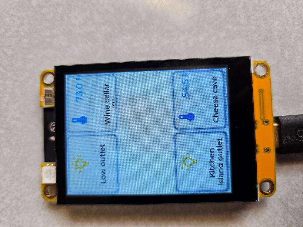

Thank you! Trusted network was an issue. Working to adjust a screen

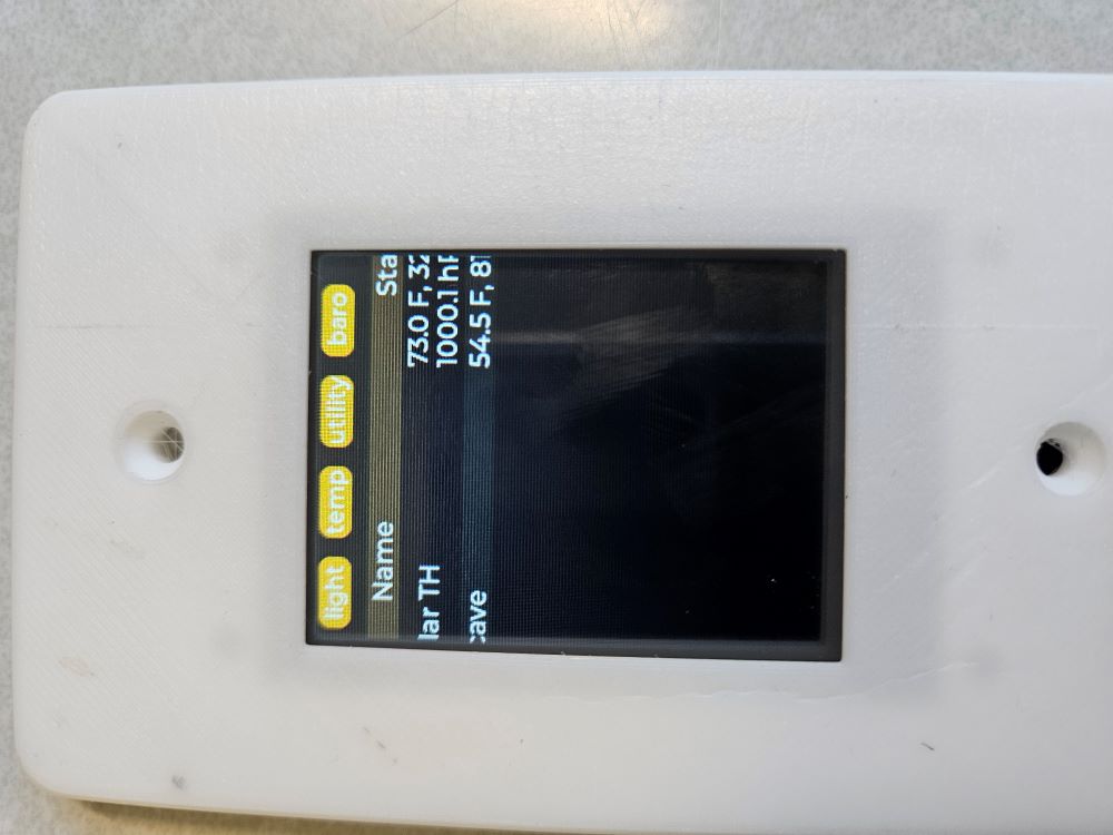

Thanks. I made a change in SETTINGS screen. On the home screen when you click any SWITCH buttons, program goes on the second screen where you can turn it ON/OFF. I want to turn ON/OFF my switches on home screen, could you please point where I can look for the event handler, I am still learning. I don't want full Domoticz menu on this small screen, just 2/3 switches, 2/3 temp sensors and that it, everything on the home screen. Thanks again.

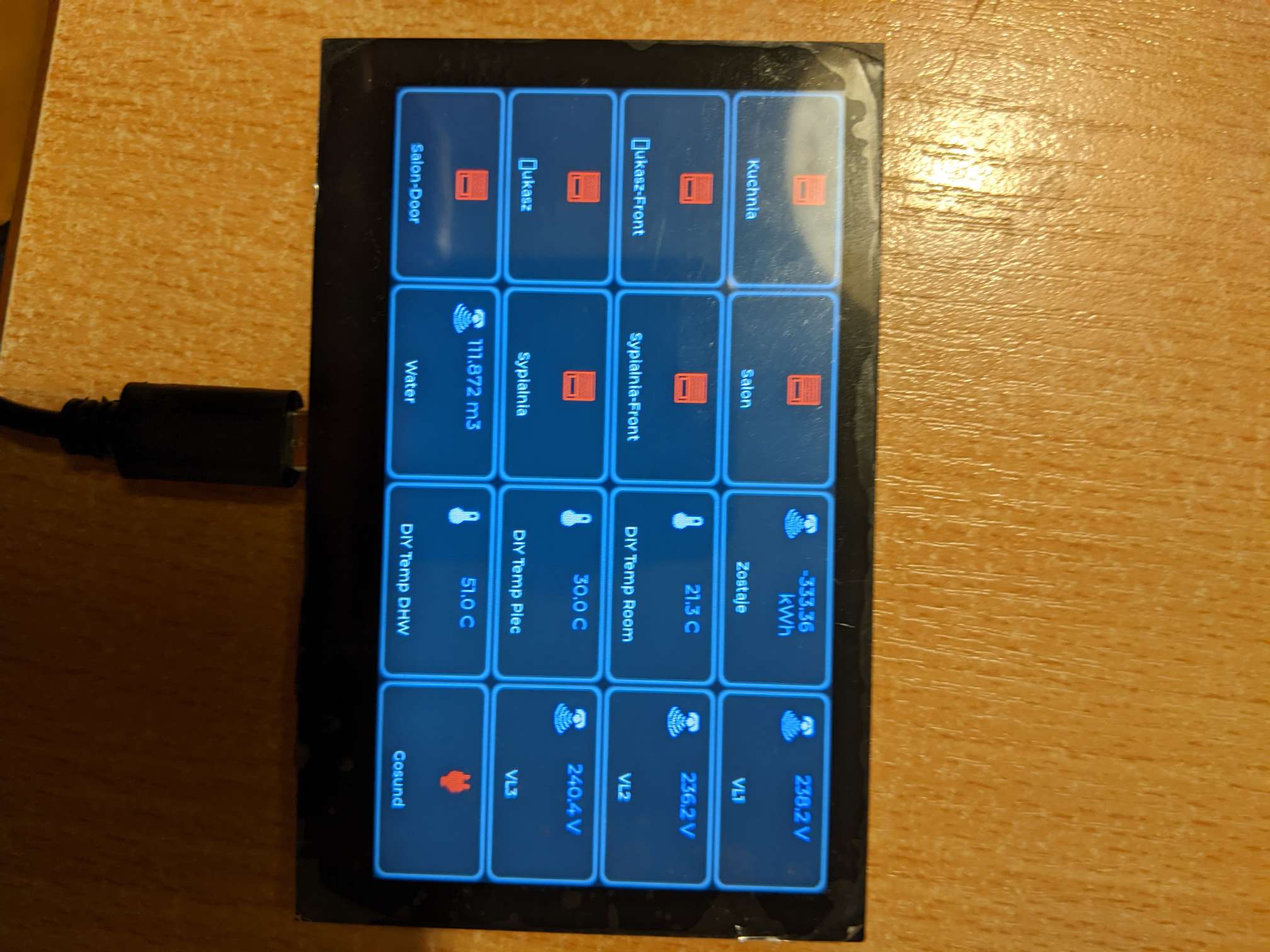

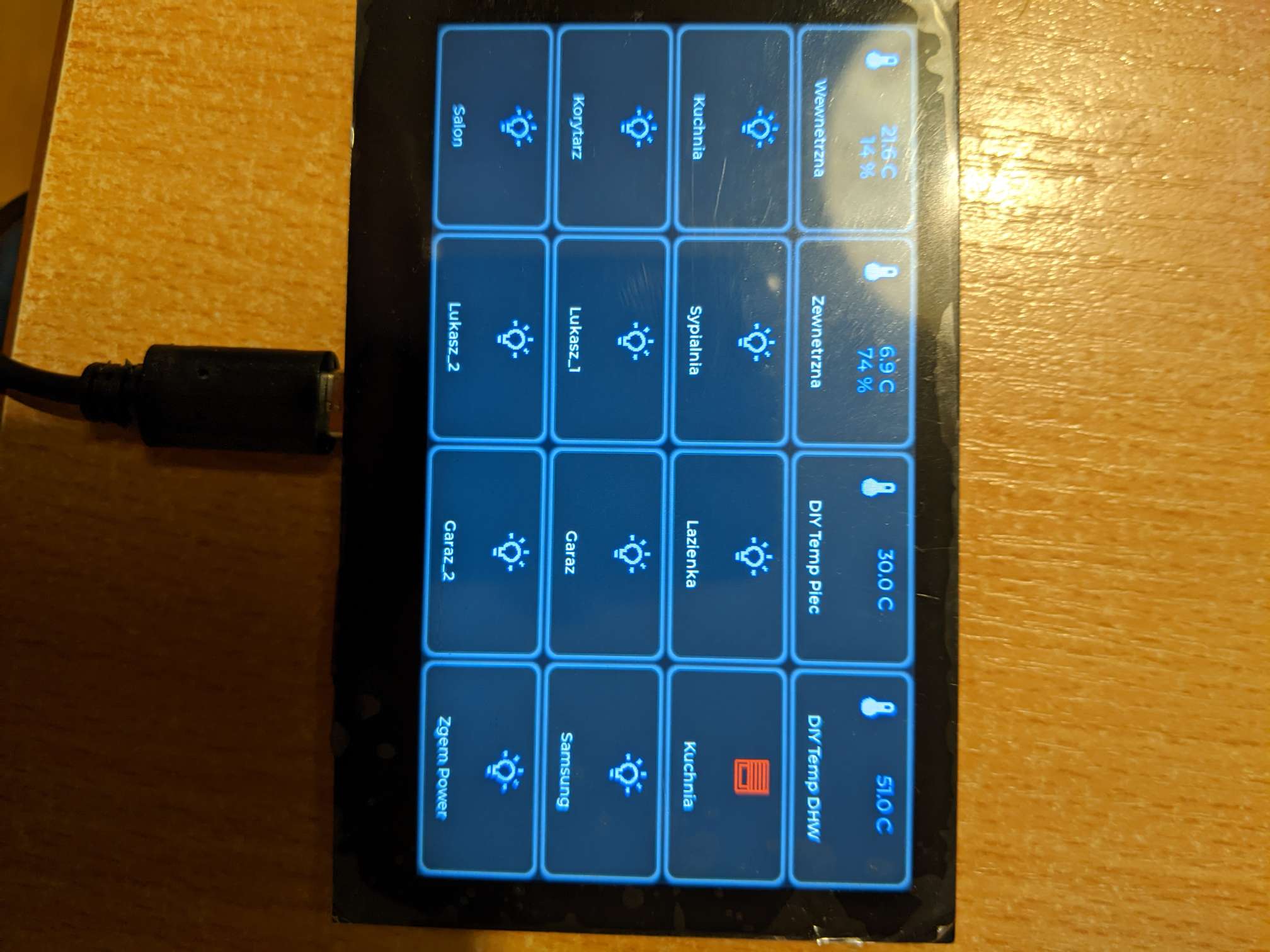

I join in the request @palnicpalnic wrote: Friday 01 March 2024 17:38 20240301_101921.jpgThanks. I made a change in SETTINGS screen. On the home screen when you click any SWITCH buttons, program goes on the second screen where you can turn it ON/OFF. I want to turn ON/OFF my switches on home screen, could you please point where I can look for the event handler, I am still learning. I don't want full Domoticz menu on this small screen, just 2/3 switches, 2/3 temp sensors and that it, everything on the home screen. Thanks again.

Come on, sir. Now this is MEGA. Just some extra pages and the project is beautiful. Respect.
