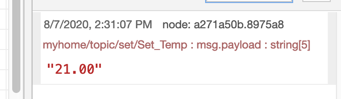

yeah, domoticz is spitting out a set/Set_Temp ...
Of course listening to the BEEP is not the only thing that matters, but If I set the timeout lower and the AC beeps every minute during the night it becomes a different problem. I had to disable node-red last night to get some sleep
2020-08-07 14:31:05 - myhome/topic/Set_Temp - 21
2020-08-07 14:31:05 - myhome/topic/Current_Temp - 20
2020-08-07 14:31:07 - myhome/topic/set/Set_Temp - 21.00
Screenshot 2020-08-07 at 14.31.57.png (25.59 KiB) Viewed 1902 times

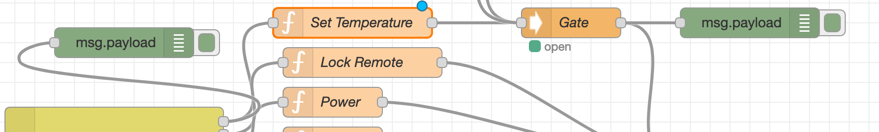

@eddieb
I see that the problem is causing trouble in the night.
No idea why, but let's check that it is really Domoticz and not something with Node Red.
Connect a "Debug" node to the first output of the "Split" node and check the results.
If it is a continuous problem, disconnect the "Gate" node to the "MQTT out" node. (Delete the line).
Disadvantage is that you cannot set the Setpoint in Domoticz.

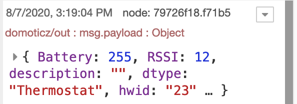

eddieb
Posts: 391
Joined: Wednesday 04 July 2018 7:48
Re: Haier AC with MQTT and nodered ?
Post by eddieb »
Screenshot 2020-08-07 at 15.20.07.png (93.08 KiB) Viewed 1899 times
Screenshot 2020-08-07 at 15.20.21.png (38.28 KiB) Viewed 1899 times
8/7/2020, 3:24:08 PMnode: 79726f18.f71b5
domoticz/out : msg.payload : Object
object
Battery: 255
RSSI: 12
description: ""
dtype: "Thermostat"
hwid: "23"
idx: 253
name: "Haier Set_Temp"
nvalue: 0
stype: "SetPoint"
svalue1: "21.00"
unit: 1
domoticz is just spitting out set commands
