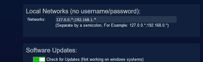

Verify that you can access Domoticz without userrname/password.Hogis wrote: Friday 17 July 2020 1:56 Getting this when trying to install:
IP/PORT OK

No, I can't even though I have added the addresses in settings.zak45 wrote: Friday 17 July 2020 19:38

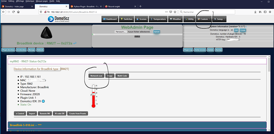

do a network scan and show the output.
show the content of the /home/pi/domoticz/plugins/broadlink/log/13RM2M.txt file

For the scan, two options:Hogis wrote: Sunday 26 July 2020 16:23
Network scan?
And I can't view 13RM2M.txt or change permission to access the file...
first one : or
open term session, go to plugin directory and run
sudo python broadlink_discovery.py
for the rights... hope you have root rights.

Ok,zak45 wrote: Sunday 26 July 2020 16:36For the scan, two options:Hogis wrote: Sunday 26 July 2020 16:23
Network scan?
first one :
or
"0x2712 192.168.0.10 780f771852b7" and "Found 0 devices --2020-07-26 17:03:15"
