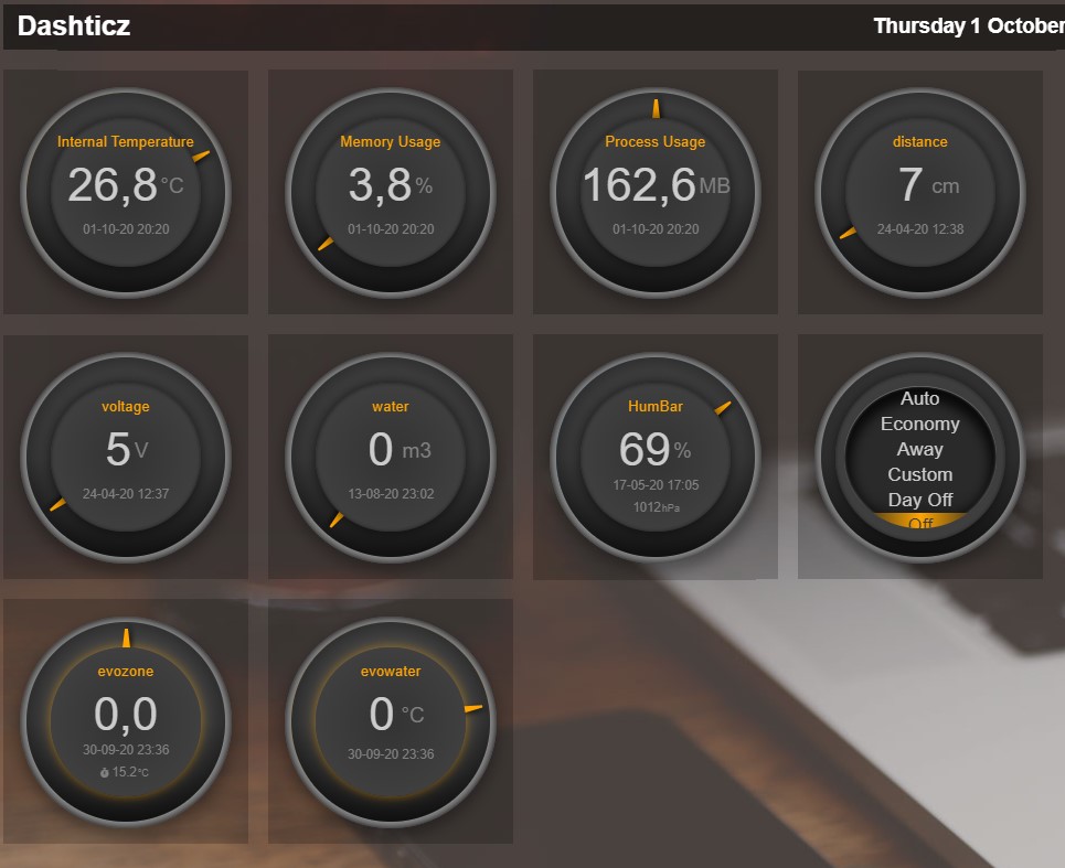

I hope some new dials will be released (Rain-gauge, Barometer with pressure value BIG in the center of the dial). Maybe if I fiddle with the custom css a lot more is possible without 'breaking' the dials.js :)

HI, I like the dials, but now some meters can and some meters can't be displayed with dials. Isn't it possible to create a custom dial with any value? Just using the value of in input and a minimum/maximum value for the scale of the gauge? It would be nice to display any watt/kwh meter with dials.
Thanks for making dashticz great!
Lokonli
Posts: 2296
Re: Dashticz Dial - Features, Fixes & Updates
Post by Lokonli »
Almost ready ...
Lokonli
Posts: 2296
Post by Lokonli »
ok.
beta 3.6.3
Give it a try :)
See:
https://dashticz.readthedocs.io/en/beta ... neric-dial
